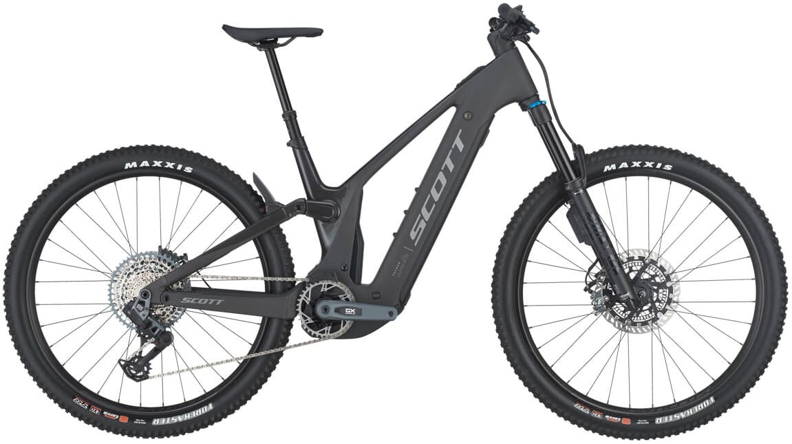

The Scott Patron eRIDE 2025 is a Swiss-designed carbon trail and enduro eMTB platform built around Bosch's Performance Line CX Gen 5 motor and Scott's signature TracLoc 2 three-mode shock control. Travel runs 170 mm at the fork (ST variants) or 150 mm (standard 900/910 trims), 150 mm rear, with a fully integrated 800 Wh PowerTube battery. Headline numbers: 120 Nm of torque, 750 W peak power, a 63.5 to 65.8 degree size-and-trim-dependent head angle, a claimed 24.3 to 25.9 kg weight depending on trim, and reach from 428 to 528 mm across an unusually deep sixteen-size lineup. £3,395 for the 920 alloy entry through £12,499 for the 900 Ultimate flagship. Community verdict: a thoughtfully integrated, well-engineered Swiss platform with the latest Bosch power and Scott's clever suspension lockout system.
Drive system and range. The Bosch Performance Line CX Gen 5 brings 120 Nm of torque and 750 W of peak power after the PU2.0 firmware update. ST Tuned trims use the Bosch CX-Race derivative, which has been flagged by owners as delivering 85 Nm of torque instantly with a quarter turn of the crank, causing unexpected wheelies for beginners. The motor weighs 2.8 kg. The 800 Wh PowerTube is removable, supporting off-bike charging. Real-world range from owners is exceptional: one user reported 850 km of cumulative range on a 750 Wh battery before charge cycle limitations kicked in. Bosch firmware updates push through the Bosch Flow app, with PU2.0 lifting earlier-generation CX motors' performance for free.
Geometry and handling. Scott uses a 16-size geometry table that combines actual frame size with travel and trim configuration. Reach grows from 428 mm in S to 528 mm in XL. Head angles vary from 63.5 degrees on the long-travel ST variants to 65.8 degrees on the shorter 150 mm 900/910 trims. Chainstays sit 448 to 455 mm. Wheelbases run 1212 to 1335 mm. The 6-Link VLK Horst Link suspension and TracLoc 2 cockpit lockout (Lockout, Traction Control, Descend) give riders three distinct modes accessible from the handlebar. 1.8-inch tapered head tube with integrated cable routing keeps the cockpit clean.
Build and value. Nine trims. The 920 entry at £3,395 in alloy with RockShox Psylo Silver and Shimano Deore is a strong value step. The base trim at £5,499 brings FOX 38 Float Factory GRIP X2 (ST variants) or FOX 36 Rhythm, FOX Float X Nude T Factory eRIDE EVOL Trunnion, Magura MT7 brakes with 220 mm front and 203 mm rear rotors, and a SRAM GX Eagle AXS Transmission. The 900 trim at £8,499 hits an impressive 22.2 kg with FOX 36 Factory and SRAM GX AXS. The flagship 900 Ultimate at £12,499 takes spec further. The standout is the 920 alloy entry at £3,395, which puts a current Bosch CX Gen 5 eMTB into Cube and Bergamont territory on price.
Community-verified strengths. Long-term Patron eRide owners praise the chassis integration: the bike achieves 24.3 to 25.9 kg system weights with a 150 mm trail-aggressive chassis and 800 Wh capacity, which is a competitive figure. The Syncros iC SL integrated cockpit on higher trims, the Kiox 300 display and TwinLock suspension levers all draw praise as thoughtfully integrated components. The frame's clearance for 29x2.6-inch tyres, central kickstand mount and SRAM UDH compatibility add genuine ownership value over multi-year use. Scott's UK dealer reach is strong.
Caveats and known gripes. The most consistent gripe is that the gear cable runs through the frame as a continuous outer housing, which means full housing replacement requires dropping the motor. Owners have figured out workarounds (replacing just the inner cable through the existing housing, or running a new cable through with care), but this is a non-trivial service ask. Jagwire-spec housings used by Scott are thinner than most aftermarket, which limits inner-cable upgrade options. The Bosch CX-Race motor on ST Tuned trims can cause unexpected wheelies for beginners. And the 16-trim ladder, while impressive, can confuse buyers without dealer guidance on which trim suits their use case.
Verdict. The Patron eRIDE 2025 suits the trail or all-mountain rider who wants a Swiss-engineered carbon chassis with integrated cockpit, Bosch CX Gen 5 power and TracLoc 2 suspension control, in a brand with strong UK dealer support. Riders chasing simpler frame architecture, removable cabling or more aggressive descending geometry should look at the Marin Alpine Trail E, the Cannondale Moterra Neo or the Specialized Levo. Production status: current.
