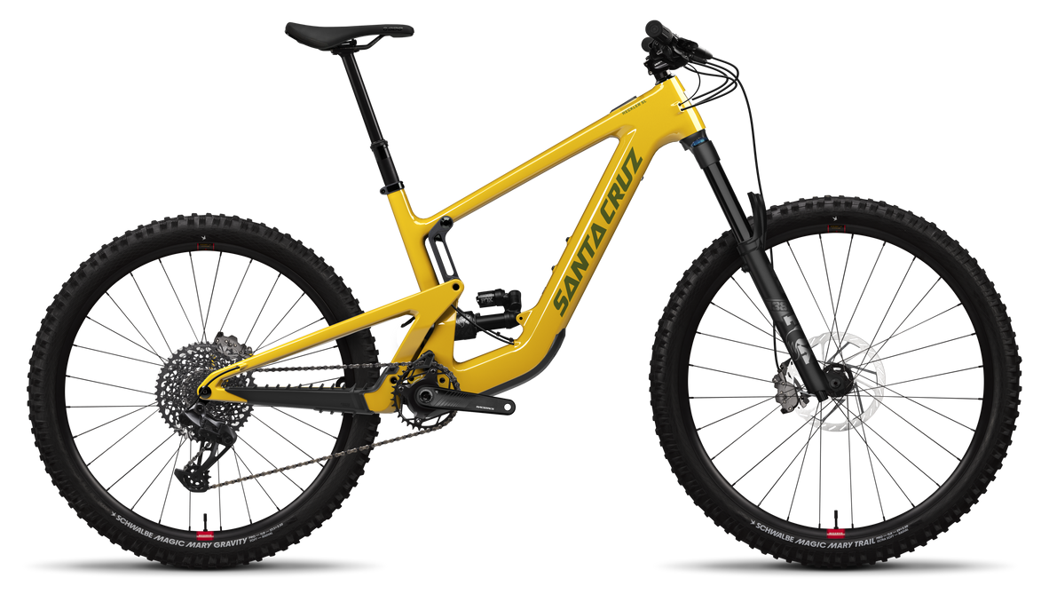

Heckler SL 2025
Lightweight VPP mullet eMTB with Fazua Ride 60 (60Nm) and 430Wh battery
The Santa Cruz Heckler SL 2025 is the Californian brand's carbon lightweight eMTB, a serious VPP-suspension platform built around Fazua's Ride 60 drive. It runs 150 mm of travel front and rear, with a removable 430 Wh Fazua Energy battery and a claimed 20 kg system weight on the base trim. Headline numbers: 60 Nm of torque, 450 W peak power, a 64 to 64.5 degree head angle and an exceptionally deep 21-size geometry table from size S (430 mm reach) to XXL (523 mm reach). Trim ladder runs from £6,699 base to £12,999 flagship CC X0 AXS RSV. Community verdict: a properly capable, beautifully refined VPP chassis with serious aggression bandwidth, paired with a Fazua motor that has divided owner experiences sharply.
Drive system and range. The Fazua Ride 60 delivers 60 Nm of torque and 450 W of peak power in a 1.98 kg motor, the lightest end of the lightweight class. Real-world range data from owners around 77 kg shows nuanced performance: 19 miles with 3,600 ft of climbing burned 88 per cent of battery in Rocket mode; 24 miles with 4,150 ft burned 99 per cent in Rocket+boost; 18.7 miles with 4,230 ft used only 51 per cent in Eco mode. The 430 Wh integrated battery is removable for off-bike charging. Owners have flagged a recurring E002 drivetrain error after wet UK winter conditions, traced to soft errors that signal yellow blinking lights. Fazua firmware updates push refinements through the Fazua Toolbox app.
Geometry and handling. A 64 to 64.5 degree head angle (varies slightly by size and frame configuration) is bang on the modern trail-aggressive norm. Santa Cruz's 21-size geometry table is among the deepest in eMTB, offering multiple S, M, L and XL options with sub-size variations on chainstay length (444 to 451 mm) and wheelbase (1210 to 1331 mm). The VPP suspension delivers what owners describe as exceptional small-bump compliance and big-hit composure, with a Cascade Link aftermarket option available to make the bike even more progressive for aggressive riders willing to add roughly 30 PSI to the Vivid shock setup. 29-inch wheels across the range.
Build and value. Seven trims, an unusually deep range. The base at £6,699 (20.02 kg) starts the line, the C S at £7,299 drops weight to 18.5 kg, the CC at £8,999 also hits 18.5 kg on the higher-grade carbon. The C XT at £9,499 weighs 18.8 kg with Shimano XT. The CC X0 at £12,999 is the lightest at 18.2 kg, and the CC X0 AXS RSV at the same price brings full SRAM AXS Transmission and Reserve carbon wheels. The standout strength is the chassis breadth and Santa Cruz's exceptional dealer support. The questionable note is Fazua Ride 60 motor reliability: see caveats.
Community-verified strengths. Long-term aggressive riders praise the Heckler SL chassis as transformative on rocky technical terrain, with one owner reporting the bike smoothes out trails 'night and day' compared to the Pivot Shuttle SL. The VPP suspension and jump-and-pop trail character draw consistent praise, and Santa Cruz's customer support reputation has held up well: the brand have confirmed they will work with Fazua to ensure long-term spares support. Build options across trims give buyers serious flexibility from value to flagship spec.
Caveats and known gripes. Fazua Ride 60 motor reliability is the most consistent and concerning community gripe. Multiple owners have reported repeated motor failures: one rider went through six motors before trading the bike in at heavy discount for a Santa Cruz Bullit. Wet UK winter conditions appear to be a particular trigger for the E002 soft error code. Owners have also flagged that the Large frame does not accept a 210 mm dropper if you have a 6-foot, 33-inch inseam, with the OneUp V3 bottoming out 40 mm below the collar. Stock OneUp V2 180 mm does not slam all the way in either, limiting dropper choices for taller riders.
Verdict. The Heckler SL 2025 suits the aggressive lightweight rider who wants Santa Cruz's premium VPP chassis with the deepest sizing options and trim choices in eMTB, and who is willing to accept Fazua Ride 60 motor reliability risk. Riders prioritising motor reliability should consider the TQ HPR60-equipped Trek Fuel EXe or Yeti MTe, or step up to full-power Bosch SX on the Santa Cruz Vala. Production status: current.
