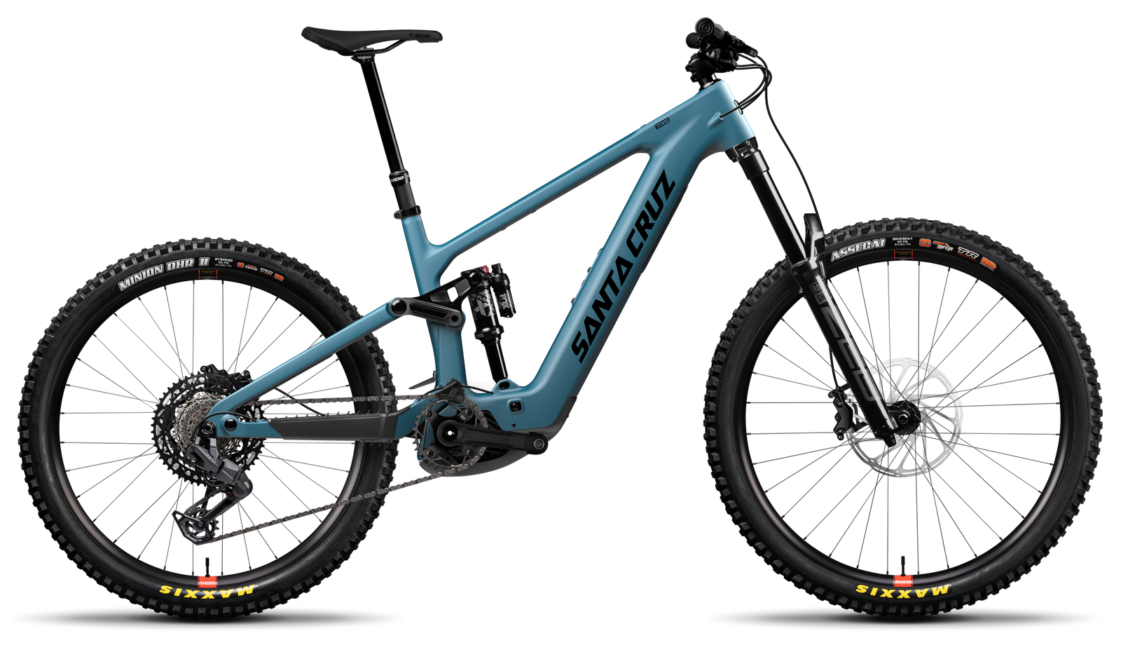

The Santa Cruz Bullit 2026 is the carbon mullet enduro flagship from Santa Cruz, built around the Bosch CX motor in 2026 trim. Headline numbers: 170mm fork, 170mm rear, 23.8kg claimed on the base, 64.0 degree head angle and reach 445 to 520mm across S, M, L and XL. Trim ladder: MX C S at GBP 8,499, MX C XT at GBP 10,499 (23.5kg) and XO AXS RSV at EUR 11,699 (22.2kg). The Bullit is one of the most established enduro eMTB platforms on sale: @Jbone5000, a 230lb rider on a Bullit C70 XL with the 600Wh internal battery, reports 1,000ft of climbing per 25% battery and finishes 3,500ft rides at ~20% remaining.
Drive system and range. The 2026 Bullit uses the Bosch CX motor system with a 600Wh internal battery as the gold-listed configuration. Riders should note: @chasmoftheclam, a 6'3" 200lb rider, finds the 600Wh limiting for 1.5 to 2 hour rides in EMTB+ and Tour modes. @chasmoftheclam also notes the Bullit can receive a 100Nm software upgrade via custom tuning. @Jbone5000's real-world AUTO/TURBO/EMTB+ mode usage discipline is the key to making the 600Wh stretch: AUTO at 70Nm/600W for climbs, TURBO for flat sections.
Geometry and handling. 64.0 degrees up front is bang on the modern enduro norm. Reach steps cleanly: 445 (S), 470 (M), 495 (L), 520 (XL). Chainstays are a uniform 455mm and wheelbase tops out at 1350mm on XL. The Bullit runs an MX mullet wheel layout (29 front, 27.5 rear) as standard, with independent geometry and shock-rate flip chips for setup tunability. The carbon C frame uses one-piece linkage with moulded chainstay, seatstay and shuttle guard plus lower down-tube protection: a serious finishing-kit story for serious shred use.
Build and value. Three trims. MX C S (GBP 8,499, 23.8kg) gets a RockShox ZEB Base 170mm fork, FOX Float X Performance 205/65mm shock, SRAM DB8 four-piston brakes and SRAM Eagle 70 mechanical T-Type. MX C XT (GBP 10,499, 23.5kg) steps up to FOX 38 Float Factory GRIP X2, FOX Float X Factory or DHX2 coil (Podium variant), SRAM Maven Silver brakes and Shimano XT Di2 M8200 electronic. XO AXS RSV (EUR 11,699, 22.2kg) is the top-tier RSV carbon build with SRAM XO AXS. Standout: SRAM Maven Silver and XT Di2 at GBP 10,499 is a flagship-grade combination. Questionable: 600Wh battery on a 170/170mm enduro is conservative: Avinox rivals offer 800Wh as standard.

Frame
Santa Cruz Carbon C front and rear triangles with one-piece linkage; moulded chainstay, seatstay and shuttle guard with lower down-tube protection; four-bar Horst-link suspension with independent geometry and shock-rate flip chips; MX wheel layout; 170mm front and rear travel.
| S | M | L | XL | |
| Reach | 445 mm | 470 mm | 495 mm | 520 mm |
| Stack | 625 mm | 635 mm | 645 mm | 655 mm |
| Chainstay | 455 mm | 455 mm | 455 mm | 455 mm |
| Headtube Angle | 64° | 64° | 64° | 64° |
| Seattube Angle (eff) | 76° | 76° | 76° | 76° |
| BB Drop | 18 mm | 18 mm | 18 mm | 18 mm |
| Wheelbase | 1275 mm | 1300 mm | 1325 mm | 1350 mm |
| Front Centre | 820 mm | 845 mm | 870 mm | 895 mm |
