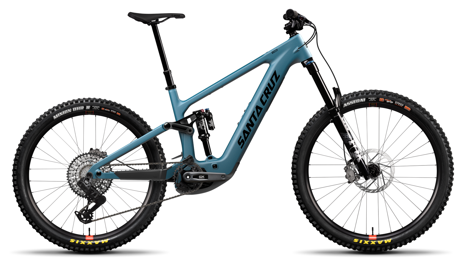

The Santa Cruz Bullit 2025 is a carbon mixed-wheel freeride/enduro eMTB built around the Bosch Performance Line CX Gen 5 motor, with 170 mm of travel front and rear, Horst Link suspension, and Santa Cruz's signature ride feel. Headline numbers: 120 Nm of torque, 600 Wh non-removable Bosch PowerTube battery, a 63.6 to 64.0 degree head angle, 21.9 kg claimed and a £9,999 base price. The community read on the 2025 Bullit is broadly positive on motor character and frame quality, with the 600 Wh battery being the single most-flagged limitation.
Drive system and range. The Bosch Performance Line CX Gen 5 delivers 120 Nm of torque and a 750 W manufacturer-claimed peak, with post-PU2.0 firmware unlocking eMTB+ mode and around 400% rider support. The 600 Wh battery is the headline compromise: chasmoftheclam chose the Norco Range VLT specifically because "the Santa Cruz Bullit has 600 Wh internal battery which limits 1.5-2hr rides in EMTB+ and Tour modes". Jbone5000 takes a different view from the C70 XL: at 230 lb with gear, he achieves "minimum 1,000 ft climbing per 25% battery, with 3,500 ft climbing rides ending at around 20% battery remaining" using TURBO sparingly. The battery is non-removable, integrated through the down tube. Jbone5000 specifically details his mode strategy: "AUTO mode detuned to 70 Nm/600 W for climbs, TURBO mode at full settings for flat sections, EMTB+ mode for singletrack" — exactly the discipline the smaller battery demands.
Geometry and handling. The Bullit runs five physical sizes (S, M, L, XL, XXL) with 13 effective configurations across the geometry flip-chip variants. Reach progresses from 435 mm to 525 mm and the head angle floats between 63.6 and 64.0 degrees, with a 440 to 455 mm chainstay range and wheelbase from 1,220 mm to 1,350 mm. Independent shock-rate and geometry flip chips give meaningful tuneability. The mixed-wheel (MX) layout with 170 mm front and rear travel is fixed — ebsocalmtb confirms "you cannot fit a 29-inch rear wheel in the frame. The tyre will contact the chainstay yoke as well as the seat-stay bridge". Genuine 29F/27.5R commitment, not optional.
Build and value. Six trims are on file: C S (base), the (base) trim, CC, CC X0 AXS RSV, C XT and CC X0 AXS, with carbon CC and C layups depending on tier. The £9,999 base is firmly premium. warracer notes the R-base build's "SRAM MTH 746 rear hubs are notorious for bearing failure due to preload design flaw", fixed by a machined aluminium spacer — useful intel for entry-trim buyers.
Community-verified strengths. First, ride feel and motor character: Jbone5000 at 230 lb covers serious vertical with disciplined mode use, so motor delivery is rated highly. Second, mixed-wheel geometry that genuinely delivers the freeride/enduro character. Third, well-developed flip-chip geometry programme.
Caveats and known gripes. First, the 600 Wh battery is the segment's biggest single compromise — chasmoftheclam explicitly traded the Bullit for the 800 Wh Norco Range VLT because of the 1.5-2 hour ride-time limit in upper assist modes. Second, the speed-limiter ceiling: Dave238 notes the "speed limiter slider maxes out at 19 mph despite the 120 Nm firmware update" — a real issue for US Class 3 riders. Third, the non-removable battery limits charging flexibility.
Verdict. The Santa Cruz Bullit 2025 suits riders who want a carbon 170 mm mixed-wheel enduro/freeride bike with the latest Bosch CX Gen 5 motor and Santa Cruz's premium frame quality, and who are comfortable disciplining their assist modes around the 600 Wh battery. Less suitable for backcountry riders who need 800 Wh-plus capacity (Mondraker Level, Norco Range VLT, Stevens E-Inception ED 9.7 are the natural alternatives), or who require a removable battery. Production status: current.
