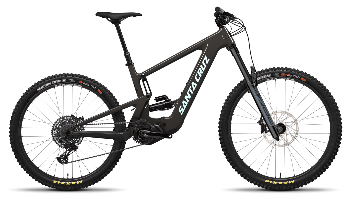

The Santa Cruz Bullit 2024 is the American brand's discontinued full-power enduro eMTB, built around the Shimano EP801 motor (85 Nm, 250 W rated, 600 W peak, 2.7 kg) and a removable 630 Wh Shimano BT-E8036 battery. The carbon frame uses Santa Cruz's signature VPP suspension layout with 170 mm front and 170 mm rear travel. Head angle is a properly slack 64.0°, claimed weight 21.85 kg, and UK pricing was £7,999. Four sizes M-XXL provide good fit range for taller riders particularly. Discontinued as of the 2025 model year transition — Santa Cruz has moved to a refreshed Bullit Gen 5 platform with Bosch CX motor for 2026. The community verdict is positive on ride feel but consistently flags the 600 Wh battery (effective capacity in the EP801-equipped Bullit configurations) as a constraint.
Drive system and range. The Shimano EP801 produces 85 Nm of torque and 600 W peak. @chasmoftheclam notes "Santa Cruz Bullit can receive 100 Nm software upgrade via custom tuning" — third-party tuning paths exist. @Jbone5000 reports detailed real-world consumption on his C70 XL: "At 230 lbs rider weight with gear/water, achieves minimum 1,000 ft climbing per 25% battery, with 3,500 ft climbing rides ending at ~20% battery remaining". The 630 Wh battery is removable for off-bike charging but is small by 2024 standards — @chasmoftheclam describes it as "limiting for 1.5-2 hr rides". Range extender options are available via aftermarket Shimano accessories.
Geometry and handling. The 64.0° head angle is properly enduro-spec. Reach progresses M 450 mm, L 475 mm, XL 495 mm, XXL 515 mm — generous modern sizing, with no S size available (Bullit is a bike for taller riders). Chainstay length is fixed at 449 mm across all sizes. Wheelbase opens 1,245-1,325 mm. The bike is mullet 29/27.5 — note that @ebsocalmtb confirms you cannot fit a 29in rear wheel: "the tire will contact the chainstay yoke as well as the seat stay bridge". VPP suspension is a Santa Cruz hallmark and delivers a planted, supportive feel on chunky terrain.
Build and value. The £7,999 base trim brings Fox Float 38 (with HT68 e-bike crown variant per @bergl), Fox Float X shock, Shimano XT brakes and a Shimano XT 12-speed drivetrain. Higher trims (R, S, X01 AXS) historically extended to £10,000+. @RSG's detailed setup notes show owners typically upgrade brakes (Shigura conversions popular), front tyres (DH casing High Roller III is common), bars and stems to dial in personal preference. The Bullit is widely available used as the 2024 spec moves out of dealers' new-bike inventory.
Community-verified strengths. @Pierrot owns both the previous-gen EP8 Bullit and the new EP801: "The first thing I noticed is that the new bike is clearly easier to climb with" — refinement is real. @Snoggin reports a strong first ride at China Camp progressing from milder front-side trails to "gnarly back side trails" with confidence. @Mojo_n_SB at 6'3" reports the bike "rips" on steep downhills and "slides into corners with continued speed". VPP suspension consistently draws praise.
Caveats and known gripes. The 600-630 Wh battery is the most-flagged constraint. @warracer documents a known bearing failure path: "SRAM MTH 746 rear hubs are notorious for bearing failure due to preload design flaw. Fix: machine aluminium spacer (inner 17.05 mm, outer 21 mm, length 53.30 mm) to permanently set correct preload" — a real DIY job needed on the base R trim. @Dave238 reports the 2025 Bosch-equipped Bullit has a speed limiter "maxes out at 19 mph despite 120 nm firmware update" — annoying for unlocking work. No 29in rear wheel option. EP801's 85 Nm is now mid-pack. Discontinued status means newer stock is being replaced by the Gen 5 platform.
Verdict. The 2024 Bullit is for the rider who can find discounted new-old-stock or used examples and wants Santa Cruz's VPP enduro chassis with proven Shimano EP801 power and a removable 630 Wh battery. It is not for short riders (no S size), buyers who need 800 Wh+ range or anyone wanting the latest Bosch/DJI motors. Production status: discontinued. The 2026 Bosch-powered Bullit has replaced it.
