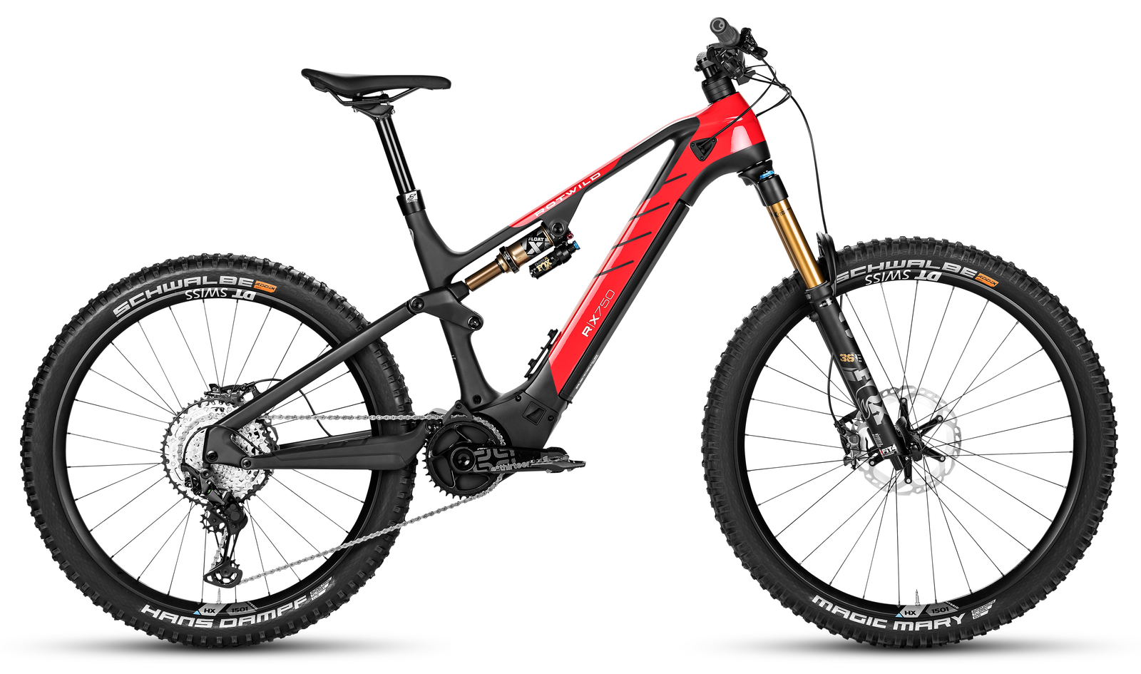

Rotwild R.X750 2023
EMTB Forums verdict
The 2023 Rotwild R.X750 was the Koblenz brand's full-power, all-mountain eMTB on the carbon IPU750 platform: a handmade full-carbon chassis with 150 mm of fork travel, 152 mm at the rear, and a mixed-wheel MX setup (29in front, 27.5in rear). Power came from the Brose Drive S Mag motor rated to 90 Nm, fed by the 720 Wh IPU750 pack carried in a Quick Release cradle.
Geometry was consistent across S to XL with a 66 degree head angle, 74 degree effective seat angle, fixed 445 mm chainstays and reach growing from 405 mm to 500 mm. It is a fairly steep front end by modern enduro standards, positioning the R.X750 as a fast, efficient big-mountain all-rounder rather than an out-and-out gravity sled.
Two builds were sold. The Core (around 7,999 euro) ran Fox Performance suspension, Magura MT5 brakes, an e*thirteen dropper and an aluminium-housing battery. The flagship Pro (around 9,999 euro) stepped up to Fox Factory Kashima 36 and Float X, Shimano XT four-piston brakes, a carbon B220 bar, an 8PINS dropper and the lighter carbon-housing pack, with a claimed 23.6 kg in size L. Both shared the same frame, motor, geometry and Schwalbe Magic Mary/Hans Dampf rubber.
This model year is discontinued; the R.X750 has since moved on to later platform revisions. Rotwild sells Europe-direct with no UK storefront, so pricing here is the native euro RRP.

MotorBrose Drive S Mag · 90 Nm · all trims
BatteryRotwild IPU 720Wh · 720 Wh · all trims
Travel F/R150/152 mm · all trims
FrameFull carbon (Vollcarbon, handgefertigt) · all trims
ForkFOX 36 Float Performance (150 mm / Fit Grip / 3-POS / Micro Adjust / E-Bike+ / OD-Crown)FOX 36 Float Factory Kashima (150 mm / FIT4 3-POS Adjust / E-Bike+ / OD-Crown)
ShockFox Float X Performance (205 x 60 mm / 2-POS / EVOL / LV)FOX Float X Factory Kashima (205 x 60 mm / 2-Pos Adjust)
HeadsetACROS RW750 1.5 Headset (with Blocklock)ACROS RW750 1.5 Headset (with Blocklock size S/M)
StemROTWILD S140 AL7075 (Ø35 mm / 50 mm / Monkeylink Interface) · all trims
HandlebarROTWILD B280 AL7075 (Ø35 mm / 15 mm Rise / 780 mm Width)ROTWILD B220 Carbon (Ø35 mm / 15 mm Rise / 780 mm Width / Carbon)
GripsERGON GD10 (Slim Factory Frozen) · all trims
SaddleERGON SMERGON SM Pro
Seatposte*thirteen Vario Covert Infinite (Individual up to 260 mm XL)8PINS H01 (Ø34.9 mm / 25 mm Offset / 145 mm S / 160 mm M / 180 mm L / 200 mm XL)
BrakesMAGURA MT5 HC-W (Shift mix); rotors: 203 / 203 (MAGURA MDR-P Sensor)SHIMANO XT 8120 (Fin Pad); rotors: 203 / 203 (SHIMANO RT800/810, Sensor ICE)
Rear derailleurShimano XT 8100 (12-Speed / SGS / Hyperglide+) · all trims
Cranke*thirteen Plus (160 mm S / 165 mm M,L / 170 mm XL); e*thirteen Direct Mount Chainring 36 t.e*thirteen Race Carbon (165 mm S/M, 170 mm L/XL); e*thirteen Direct Mount Chainring 36 T.
ShiftersSHIMANO XT (I-Spec EV)SHIMANO XT 8100 (I-Spec EV)
CassetteSHIMANO CS 6100 (10-51 t. / 12-Speed)SHIMANO CS 7100 (10-51 T. / 12-Speed)
ChainSHIMANO HG 7100 (12-Speed) · all trims
DrivetrainShimano XT 8100 (12-Speed / SGS / Hyperglide+); e*thirteen Plus (160 mm S / 165 mm M,L / 170 mm XL); e*thirteen Direct Mount Chainring 36 t.; SHIMANO XT (I-Spec EV); SHIMANO CS 6100 (10-51 t. / 12-Speed); SHIMANO HG 7100 (12-Speed)SHIMANO XT 8100 (12-Speed / SGS / Hyperglide+); e*thirteen Race Carbon (165 mm S/M, 170 mm L/XL); e*thirteen Direct Mount Chainring 36 T.; SHIMANO XT 8100 (I-Spec EV); SHIMANO CS 7100 (10-51 T. / 12-Speed); SHIMANO HG 7100 (12-Speed)
WheelsDT SWISS H1900 Spline (30) (Ratchet LN 18 / 110-15/148-12 TAS / 6-Bolt)DT SWISS HX1501 SPLINE1 (30) (Ratchet EXP OS 30 / 110-15/148-12 TAS / CL)
TyresSCHWALBE Magic Mary / Hans Dampf (EVO Super Ground / Trail TLE Soft / 29 x 2.40 / 27.5 x 2.60) · all trims
Weight23.6 kg
