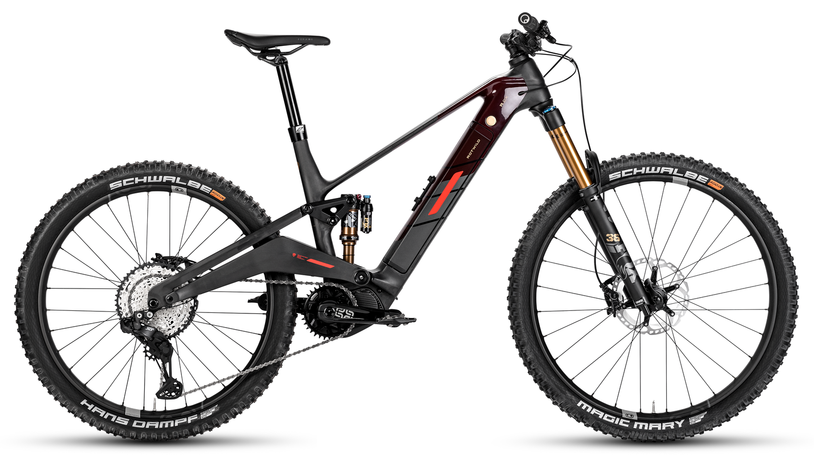

The Rotwild R.EX 900 2026 is a German-built carbon enduro eMTB and Rotwild's range-first Avinox flagship. Headline numbers: 170mm fork, 160mm rear (frame notes describe 160 front / 150 rear, indicative of conservative travel positioning), DJI Avinox M1 at 105Nm and a 1000W peak with a 2.52kg motor mass, a removable 864Wh battery, 22.4kg claimed, 64.0 degree head angle and reach 462 to 512mm across M, L and XL. Trim ladder: base at GBP 11,999 and ULTRA at EUR 12,490 (22.1kg). With no curated community quotes on file yet, this verdict draws on the gold spec and the well-established DJI Avinox platform behaviour. Rotwild has a long heritage in premium German eMTB engineering with a small but devoted following.
Drive system and range. The DJI Avinox M1 is the most powerful production motor in its tier in 2025: 105Nm of torque, 1000W peak and a 2.52kg motor mass. Avinox can sustain peak torque longer than rival full-power motors thanks to large gearbox surface area and aggressive thermal mapping. Rotwild has fitted a notably large 864Wh battery: bigger than the standard Avinox FP800: making the R.EX 900 a deliberate range-first build. The battery is removable. Real-world range with 864Wh on a 160/170mm rig is genuinely capable of 2,000m+ of vertical in a single charge for typical riders, well into all-day backcountry territory. Avinox's app ecosystem, anti-theft alarm, 4G/GPS and over-the-air firmware updates come built in.
Geometry and handling. 64.0 degrees up front is bang on the modern enduro norm. Reach steps cleanly: 462 (M), 487 (L), 512 (XL). Chainstays are a uniform 439mm and wheelbase tops out at 1303mm on XL. The polydynamic carbon frame uses mid-high pivot kinematics with a mullet wheel concept (29 front, 27.5 rear), modular dropouts and an Acros RW EXC angle-adjustable headset: all genuine engineering depth from Rotwild. Three sizes is on the conservative side; riders under 1.70m or over 1.95m should fit-check.
Build and value. Two trims. Base (GBP 11,999, 22.4kg) gets a FOX 36 Float Performance fork (160mm, GRIP damper), FOX Float X Performance shock (185x55mm), MAGURA MT5 HC-W four-piston brakes and Shimano XT M8100 1x12 mechanical. ULTRA (EUR 12,490, 22.1kg) is the higher-tier build. Standout: 864Wh removable battery on a 22.4kg carbon enduro rig is class-leading for range-per-weight. Questionable: GBP 11,999 base pricing puts it firmly in YT Decoy Carbon Pro and Specialized Kenevo Pro territory, where carbon AXS Transmission and Maven brakes are standard.

Frame
Polydynamic carbon frame handcrafted from high-modulus carbon fibres with mid-high pivot kinematics, mullet wheel concept (29 in front / 27.5 in rear), modular dropouts and Acros RW EXC angle-adjustable headset, 160 mm front / 150 mm rear travel
