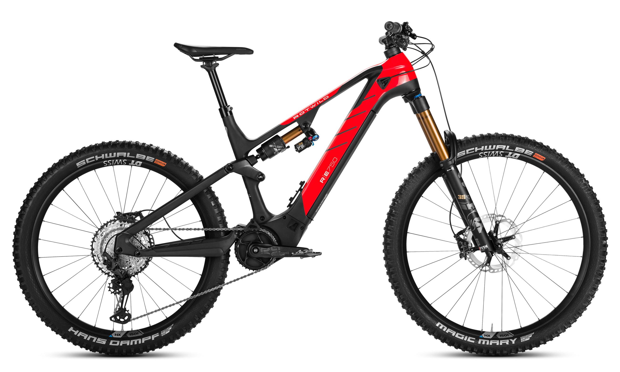

Rotwild R.E750 2022
EMTB Forums verdict
The Rotwild R.E750 was the German brand's full-power enduro flagship for 2022, pairing a hand-made full carbon chassis with 170 mm up front and 162.5 mm at the rear. Power came from the Brose Drive S Mag with its air cooler and up to 90 Nm, fed by Rotwild's own 750 Wh IPU750 pack, and it ran a mullet wheel setup with a 29in front and 27.5in rear.
Geometry was contemporary enduro rather than extreme, with a 65 degree head angle, 73.5 degree effective seat angle and a fixed 445 mm chainstay across the S to XL range. Two build tiers were offered. The Core at 7,999 euros paired a Fox 38 Performance fork with Magura MT5 brakes on 220/203 mm rotors, while the 9,499 euro Pro stepped up to Fox 38 Factory Kashima, a Float X2 Factory shock, Shimano XT four-piston brakes and DT Swiss HX1501 wheels.
This 2022 model has since been discontinued. It remains a niche, boutique option built around the distinctive Brose Drive S Mag motor with its dedicated air cooler and Rotwild's own integrated 750 Wh IPU750 battery.
Geometry read
Size
Descending
61
A solid all-round descender (65° head angle, 162mm) — capable in the rough and steep without being an all-out bruiser.
Playfulness
54
Size balance
97
Rear-long with a planted front in L (FC:RC 1.80) — easy to weight the front and quick to turn, though it can feel light at the back at real speed.
Technical climbing
65
Climbs well — a 73.5° seat keeps the front planted. 560W of peak power and 90Nm of torque — a strong full-power motor.
