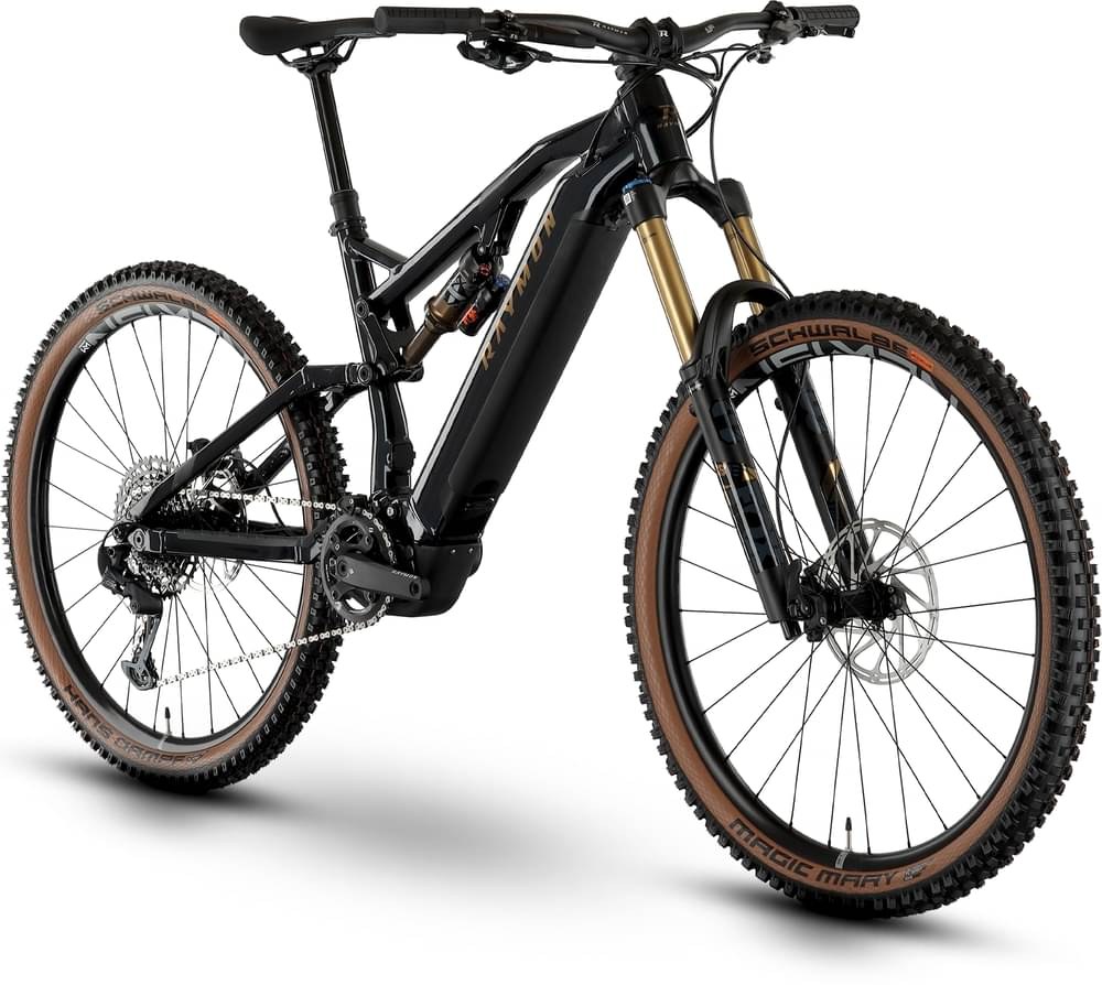

Bike Finder · R Raymon
R Raymon TrailRay E 10.0
R Raymon
TrailRay E 10.0 2025
CurrentFull power eMTBAgeing · 3.8/10iFreshness 3.8/10
Motor
Yamaha PW-X3 · 85Nm · 500W
Battery
Simplo 720Wh
Travel F/R
170/160mm
Wheels
mullet (29" front / 27.5" rear)
Frame
Aluminium
Weight
23.3 kg
Price
£5,999
View the R Raymon TrailRay E 10.0 on R Raymon’s site
R Raymon TrailRay E 10.0 2025
From £5,999
EMTB Forums verdict
The R Raymon TrailRay E 10.0 2025 is an Austrian-built full-power aluminium trail eMTB that has earned a cult value reputation in the UK eMTB Forums community. The bike runs 170 mm of fork travel and 160 mm rear on a Horst Link chassis, with Yamaha's PW-X3 motor and a removable 720 Wh Simplo battery. Headline numbers: 85 Nm of torque, 500 W peak power, a claimed 23.3 kg system weight, a 64 degree head angle, a 460 mm chainstay and reach from 445 to 510 mm across four sizes. £5,999 base trim, with the brand frequently appearing on dealer sales considerably below that. Community verdict: an under-the-radar but seriously capable trail eMTB that delivers Pierer Mobility Group engineering at a sharp price.
Drive system and range. The Yamaha PW-X3 is one of the lightest full-power motors at 2.75 kg, with 85 Nm of torque and 500 W of peak power. It is known for a responsive natural feel and reliable long-term service through Yamaha's worldwide network. The Simplo 720 Wh battery is removable for off-bike charging and supports 4 A fast charging. Real-world range from owners on UK terrain is impressive: one rider logged 31.6 miles with 3,812 ft of ascent in the Peak District on a single charge. Another reported a 40-mile hard off-road ride in snow and mud with 20 per cent battery remaining. The Yamaha X control system is described as basic but reliable, with riders able to add a Sigma 1300 computer for additional features.
Geometry and handling. A 64 degree head angle is bang on the modern enduro norm, matching the Cannondale Moterra Neo and Marin Alpine Trail E. Reach grows from 445 mm in S to 510 mm in XL, a 65 mm spread that suits a wide range of riders. The 460 mm chainstay is on the longer side of the trail-eMTB market, identical across all sizes, which favours stable climbing and high-speed composure. Wheelbases run 1241 to 1313 mm. Owners describe the geometry as confidence-inspiring on the full spread of trail conditions from red trails to black off-piste, snow and mud.
Build and value. One trim, £5,999 list price but frequently available on dealer sales (Paul's Cycles have offered the TrailRay 160 around £2,000 on Cycle2Work in recent stock). Build details at this trim follow the TrailRay 140E template: Yamaha PW-X3 motor, Simplo 720 Wh battery, mid-spec drivetrain (Shimano Deore 10-speed or SRAM SX) and Tektro HD-M745 four-piston brakes. The standout strength is the motor-and-battery package at this price: Yamaha PW-X3 with 720 Wh on an aluminium chassis with modern geometry is a serious offering for the money. The questionable note is the entry-level drivetrain and the SR Suntour or RockShox Domain fork on certain trims, which are functional but invite upgrade.
Community-verified strengths. Long-term owners report exceptional value-for-money, with one rider noting that the motor, battery and suspension package alone add up to more than the bike's discount price. Range and reliability on UK terrain is repeatedly praised. The Pierer Mobility Group connection (same stable as Husqvarna and GasGas e-bikes) gives the chassis some shared engineering DNA with bigger brands. Component spec is upgradable as parts wear, which suits buyers who want a starting platform rather than a finished build.
Caveats and known gripes. R Raymon has no UK dealer network as of 2025: Paul's Cycles sells stock acquired through what appear to be Pierer Mobility Group commercial arrangements. This makes warranty support unusual: buyers need to confirm process before purchase. The Tektro brakes have been flagged as requiring two-finger braking on steep descents, suggesting they sit below the chassis's potential. Fitting third-party accessories like a Knog Scout tracker under the bottle cage requires aftermarket shorter screws, as supplied screws can damage the battery shroud. The Yamaha X control system is basic by modern Bosch Smart System or DJI Mimo standards, and there is no app-based firmware push.
Verdict. The TrailRay E 10.0 2025 suits the value-led trail rider who wants Yamaha PW-X3 reliability, a 720 Wh battery and modern trail geometry on an aluminium chassis at well below typical brand pricing, particularly if available through a dealer sale. Riders wanting strong UK dealer reach, newer Bosch or DJI Avinox drives, or higher-end component spec should look at the Cube Stereo Hybrid, the Bergamont E-Trailster or the Specialized Levo Alloy. Production status: current.
