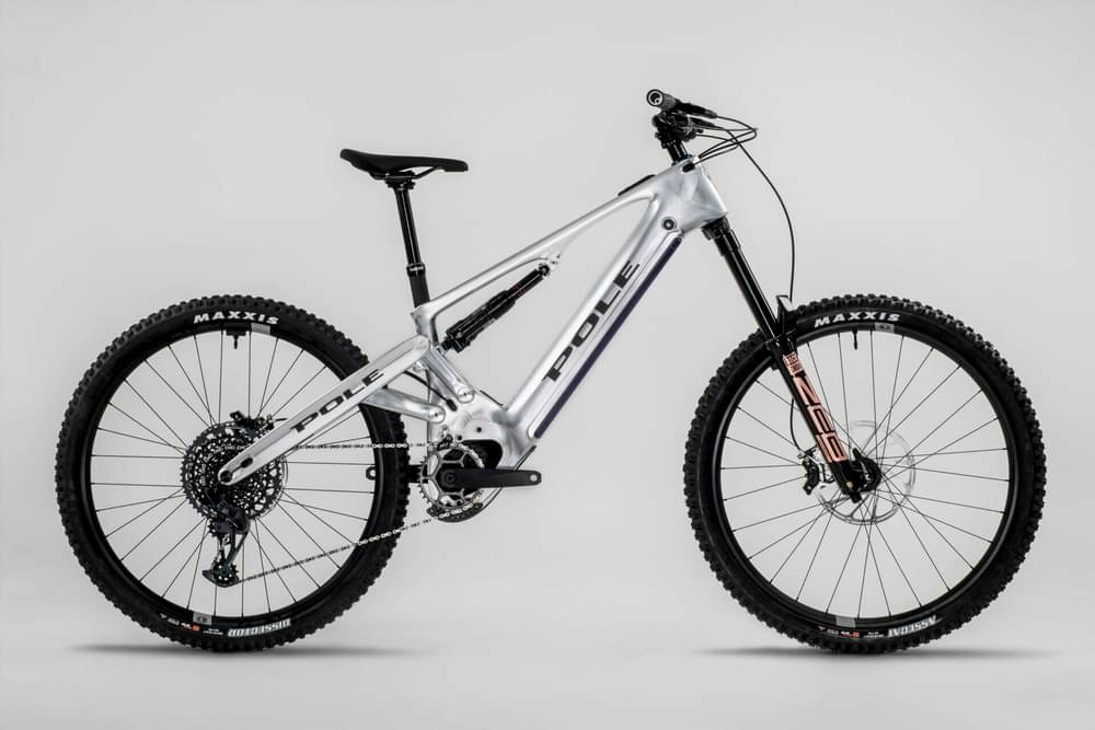

The Pole Voima 2023 was the Finnish brand's flagship 190 mm-travel CNC-machined aluminium eMTB, built around the Bosch Performance Line CX Gen 4 motor (85 Nm torque) and a 750 Wh Bosch PowerTube battery. Travel is properly aggressive at 190 mm front (or 200 mm dual-crown option) and 190 mm rear on a seamless CNC-machined and bonded 7075-T6 aluminium chassis with Pole's Sensei dual-link suspension. Three trims — Downduro Complete at £6,658 (25.82 kg), Enduro Complete at €6,443 (25.5 kg), and Trail Complete. Sixteen size/configuration combinations based on rider height (155-200 cm), reach 427-519 mm, head angle 62.6 to 64.0 degrees (size-dependent), chainstays 455 mm flat. The community read in one line: a genuinely transformative super-enduro/downduro Finnish eMTB with bonded CNC-machined alloy construction unlike anything else on the market, now discontinued, with documented frame failure concerns.
Drive system and range. The Bosch CX Gen 4 was the proven full-power Bosch motor — 85 Nm torque, 750 Wh PowerTube battery, free OTA firmware updates and the deepest dealer network in eMTB. Real-world range will sit in the 50 to 70 km territory in mixed terrain on Trail/eMTB mode. @D3xt3rMTB's Voima K4 ships with the 750 Wh battery plus an additional 500 Wh battery for 1,250 Wh combined — properly all-day shuttle capability.
Geometry and handling. Properly Pole — extreme size range and extreme geometry. The 16 size/configuration combinations are based on rider height intervals (e.g. 155-165 cm, 166-176 cm, 177-187 cm, 188-200 cm). Reach progresses from 427 mm (smallest) to 519 mm (largest). Head angles 62.6 to 64.0 degrees depending on size and flip-chip position — properly slack DH-adjacent territory. Chainstays held at 455 mm flat. The Sensei dual-link suspension is Pole's signature kinematic. The wheelbase data in GOLD shows 985-1082 mm which appears truncated (real-world wheelbases on a 190 mm travel platform with 425-520 mm reach are typically 1200-1400 mm) — buyers should check Pole's published geometry tables directly.
Build and value. Three trims well-spaced. Downduro Complete at £6,658 (25.82 kg) gets RockShox ZEB Select single-crown fork at 200 mm travel (190 mm option), RockShox Super Deluxe Ultimate shock, SRAM Code R / Code RSC 4-piston brakes. Enduro Complete at €6,443 (25.5 kg) steps to single-crown 190 mm front. Trail Complete is the entry. @Zimmerframe documents Voima K2 specs: Bosch CX with 750 Wh PowerTube, RockShox Zeb Select 190 mm fork, Maxxis Assegai 2.5 front and DHR II 2.4 rear with DD 3C MaxxGrip casings — strong stock build for the discontinued price point.

Frame
Seamless CNC-machined and bonded 7075-T6 aluminium frame with Sensei dual-link suspension; 190 mm rear travel paired with either a 200 mm dual-crown or 190 mm single-crown fork; 29-inch or MX wheels; integrated 750 Wh Bosch PowerTube battery.
