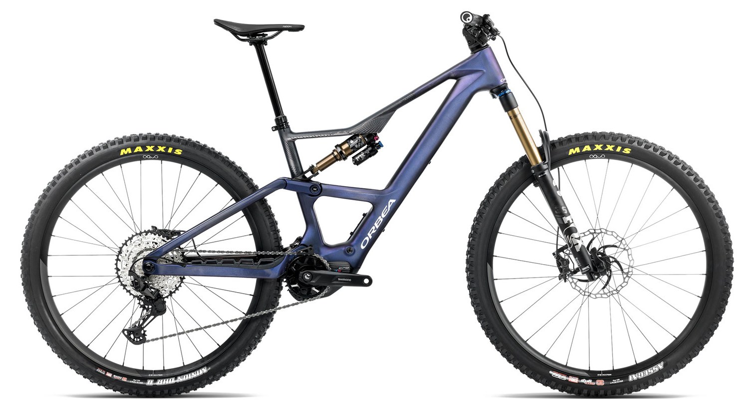

The Orbea Rise LT 2025 is the Spanish brand's premium lightweight all-mountain platform: a carbon chassis with 160 mm of fork travel paired with 150 mm of rear, Shimano EP801 RS motor (85 Nm torque, 500 W peak) tuned by Orbea for the lightweight Rise concept, and a non-removable integrated 420 Wh battery. At a claimed 19.0 kg and £7,599 for the carbon M-trim base, the Rise LT sits in the upper-mid premium segment. Eight size options across S–XL with reach progression from 430–505 mm and dual head-angle settings (64.5° or 65.0°) via flip-chip give one of the most adjustable fit profiles in the class.

Caveats and known gripes. Headset cable routing is the most-cited complaint. @levity reports "multiple cables running through the headset" on the Rise LT and @skizzian notes it can be problematic and requires special handlebars accepting cabling under the grips. @skizzian on 2023-model Rises had a stainless top bearing and a rusty nitrided bottom bearing — a service caveat. @levity on a 2025 Rise LT M10 ordered a Fox DHX1 coil shock and swapped the factory Fox 36 fork for a Marzocchi Bomber Z1 coil — signalling that some riders find the stock air suspension under-damped. @levity notes the Large frame's stock 200 mm dropper put extended seat height too high for his 5'11" frame; swapping to a 170 mm dropper fixed it. The 420 Wh battery on the base spec is the platform's biggest limitation; the 630 Wh option is the practical choice for serious riders. @Backflip is sceptical of Orbea's "RS" marketing as a meaningful drivetrain differentiator versus stock EP801.
