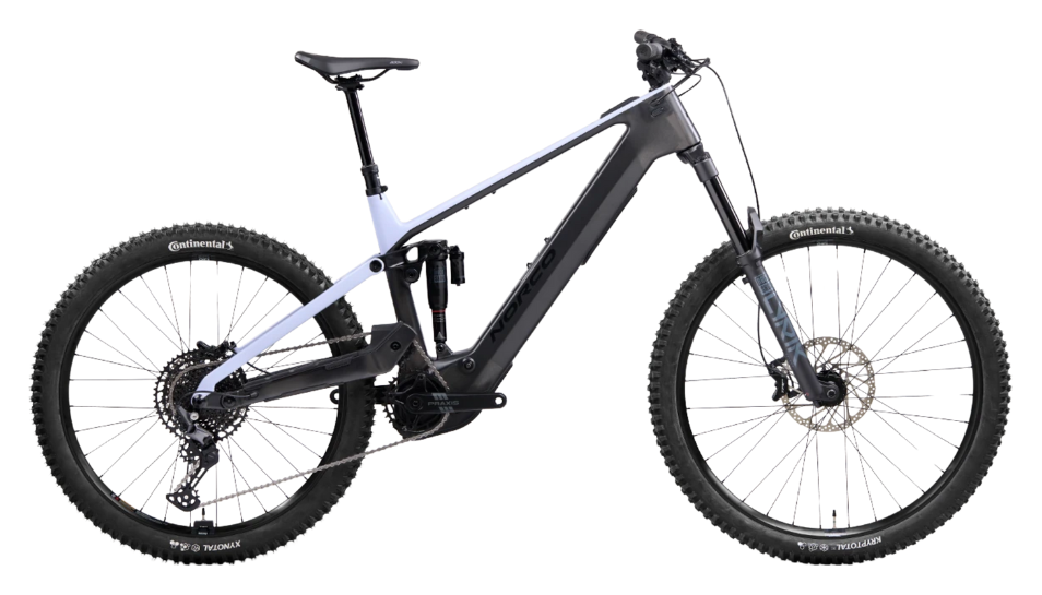

Carbon all-mountain eMTB with Bosch CX Gen 5 motor, high-pivot suspension and ~20% lighter chassis.
The Norco Sight VLT 2026 is a carbon high-pivot all-mountain eMTB built around Bosch's latest Performance Line CX Gen 5 motor and an 800 Wh removable PowerTube battery. It runs 160 mm of fork travel and 150 mm rear via Norco's VPS-HP high-pivot Horst-link suspension with a chainstay-mounted dynamic idler. Headline numbers: 120 Nm of torque, 750 W peak power, a 64 degree head angle, a claimed 21.8 kg system weight on the base trim and an extraordinary seventeen-size geometry table from size 1 (423 mm reach) to S5 (522 mm reach). £7,799 base trim. Community verdict: a hugely impressive carbon high-pivot all-mountain platform with insane range, deep sizing options and proper UK community traction.

Frame
Full-carbon front triangle and rear, VPS-HP high-pivot Horst-link suspension with chainstay-mounted dynamic idler, 150mm rear travel, mullet 29in/27.5in wheels, internal cable routing, integrated frame protection, Bosch PowerTube 800Wh integration, Ride Aligned design.
