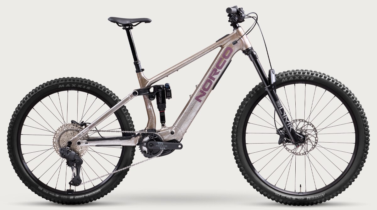

The Sight VLT Bosch A is Norco's aluminium, full-power entry into the Sight VLT line, built around the Bosch Performance Line PX motor (90 Nm, up to 700 W) and a 600 Wh Bosch PowerTube that takes an optional 250 Wh range extender. With 160 mm of fork travel and 150 mm at the rear on the VPS platform, plus a mixed 29in front / 27.5in rear wheel setup, it sits squarely in all-mountain territory. The geometry is consistent across all five sizes at a 64-degree head angle, with size-specific reach from 430 mm (S1) to 510 mm (S5) and effective seat angles steepening from 77 to 78 degrees as the frames grow.
The three builds share frame, motor, battery and finishing kit, so the choice is suspension and drivetrain. The A1 is the standout for componentry: RockShox Lyrik Select+ and Super Deluxe Select+ damping paired with Shimano's wireless Deore Di2 12-speed shifting, a claimed 23.8 kg at S3. The A2 keeps the RockShox air package one tier down (Lyrik Base, Super Deluxe Base) and runs mechanical Deore shifting with an XT rear mech. The A3 is the value pick, swapping to a DVO Diamond fork and Topaz shock, Shimano CUES 11-speed and TRP Slate EVO brakes.
Brakes are four-piston throughout with a 203 mm front rotor, and every build gets the aggressive Maxxis Assegai front, Minion DHR II rear tyre pairing, so grip and stopping power are not where Norco has saved money. Pricing is quoted in North American currency at launch (A1 $6,599, A2 $5,699, A3 $4,799 USD); a UK GBP RRP was not published at the time of writing.
