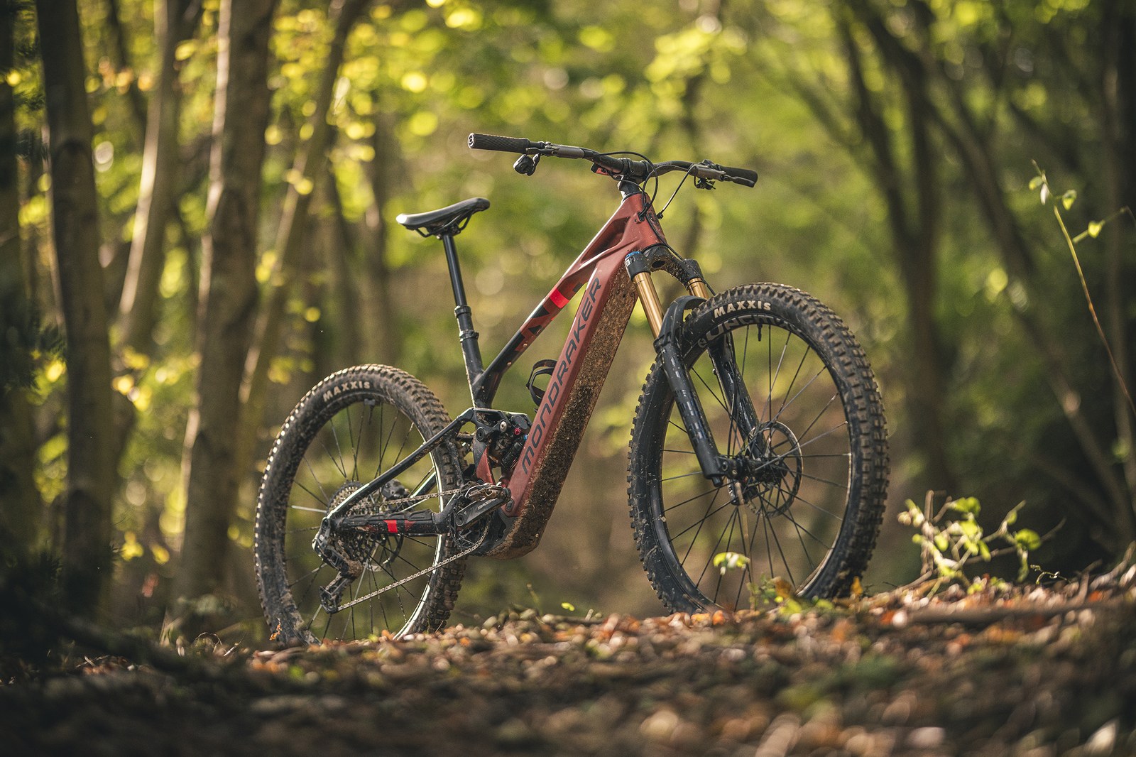

The Mondraker Dune 2025 is a carbon mullet super-enduro eMTB built around the Bosch Performance Line SX motor in lightweight enduro form. Headline numbers: 170mm fork, 165mm rear, Bosch SX at 55Nm and 600W peak with a 2.0kg motor, a removable 400Wh CompactTube battery, 20.4kg claimed, 64.0 to 64.5 degree head angle and reach 435 to 510mm across S, M, L and four XL variants. Trim ladder runs base/R at GBP 5,999, RR at GBP 8,299 and XR at GBP 10,199. Community read: @Weeksy demo-rode the XR and called it "so playful and fun", clocking 40km of vertical with 27% battery remaining in eco/off modes.
Drive system and range. The Bosch Performance Line SX is the lightweight half of Bosch's eMTB range: 55Nm of torque, 600W peak and a 2.0kg motor mass. It rewards higher cadence (100 to 130rpm) and gives natural, lively power delivery rather than the locomotive shove of CX. The 400Wh CompactTube battery is removable. A Bosch 250Wh range extender is available, taking the package to 650Wh effective for big-day rides. @Weeksy's 40km vertical with 27% remaining is testament to how far the 400Wh stretches when discipline is applied. Bosch's Flow app, Kiox 300 display, OTA firmware updates and ABS-ready hardware are baked in.
Geometry and handling. 64.0 degrees on the XL low position, 64.5 across the rest, with Mondraker's signature Forward Geometry: long reach (485mm on L, 510mm on XL) paired with very short 438mm chainstays. Wheelbase tops out at 1309mm on the XL low. Mullet wheel setup sharpens cornering on tight singletrack. The Zero Suspension System's updated linkage delivers a progressive, supportive rear that pairs well with the Öhlins coil shock on the XR trim.
Build and value. Four trims with meaningful jumps. Base/R (GBP 5,999, 20.4kg): Fox 38 Float 3P Performance, Fox Float X Performance EVOL, SRAM DB8 Stealth four-piston, SRAM GX/NX mechanical mix. RR (GBP 8,299, 19.6kg): Öhlins RXF 38 M.2 with TTX18 cartridge, Öhlins TTX Air, SRAM Code Bronze, SRAM GX AXS T-Type wireless. XR (GBP 10,199, 19.8kg): Öhlins RXF 38 M.2 at 180mm, Öhlins TTX22M.2 coil, SRAM Code Ultimate, SRAM X0 AXS T-Type. Standout: 19.6 to 20.4kg system weight on a 170/165mm super-enduro is properly impressive. Questionable: Öhlins suspension on the higher trims is excellent but service intervals and cost are steeper than mainstream RockShox or Fox.
