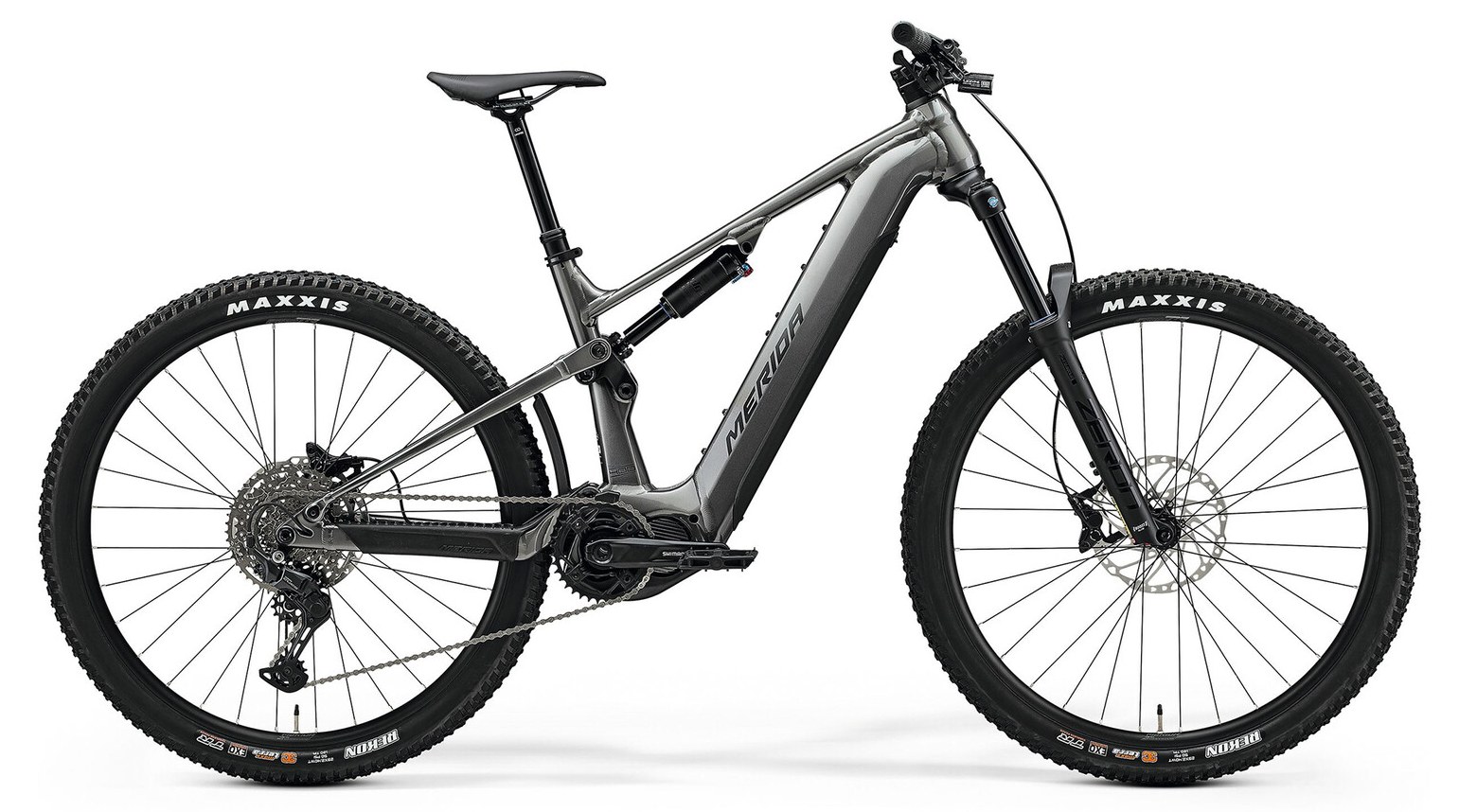

Aluminium 29er full-suspension trail on Shimano EP801 85Nm
The Merida eONE-FORTY 2025 is the trail-focused full-suspension eMTB from Merida, the LITE 750 trim built around a Shimano EP801 motor (85 Nm torque, 600 W manufacturer-claimed peak) and a 750 Wh Trendpower battery on a LITE 6061 hydroformed aluminium chassis. Travel is 150 mm front and 143 mm rear via single pivot suspension. Single LITE 750 trim at £4,999, claimed weight 23.5 kg. Five sizes from XS to XL, reach 431-511 mm, head angle 66.5 degrees flat, chainstays 449 mm. The community read in one line: a solid mid-market trail eMTB with a generous 750 Wh battery at a competitive price, hampered by traditional trail geometry and a documented stock rear shock issue on prior models.

Verdict. The Merida eONE-FORTY LITE 750 2025 is a sensible, value-orientated trail eMTB for buyers who want the Shimano EP801 ecosystem in an aluminium chassis at under £5,000. It suits intermediate trail riders, particularly those who appreciate the generous five-size range and the 750 Wh battery for long days out. Look elsewhere if you want modern slack-and-long geometry, the latest Bosch CX Gen 5 or DJI motor tech, or progressive four-bar suspension. Production status: current, single LITE 750 trim, five sizes.
