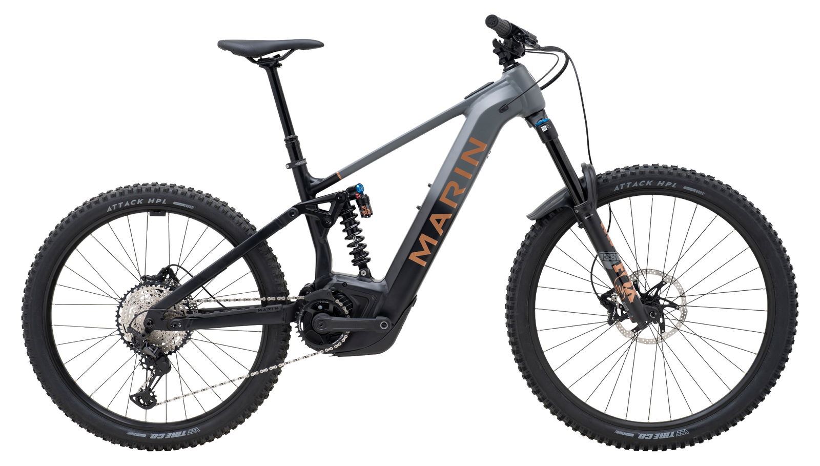

Aggressive 170/160mm aluminium enduro e-bike on Bosch CX Gen 5 with adjustable headset and chainstay flip-chip, TRP DH-R EVO brakes and Marin MultiTrac LT suspension.

The Marin Alpine Trail E 2025 is a 170/160 mm aluminium enduro eMTB that has earned a serious reputation in the eMTB Forums community as a tough, capable, value-led platform. The 2025 generation runs the latest Bosch Performance Line CX Gen 5 motor with a removable 750 Wh PowerTube, on Marin's MultiTrac LT four-bar rear end with an adjustable headset cup and chainstay flip-chip. Headline numbers: 120 Nm of torque, 750 W peak power, a 63 degree head angle, a 443 mm chainstay and a claimed 27.8 kg system weight. £5,299 for the base E2 Bosch trim. Community verdict: a rock-solid enduro tool that competes with bikes £2,000 dearer, with adjustable geometry to dial fit and feel.
Drive system and range. The Bosch Performance Line CX Gen 5 brings 120 Nm of torque and 750 W of peak power after Bosch's PU2.0 firmware update, taking it well above the older Gen 4's 85 Nm headline. The motor weighs 2.8 kg. The 750 Wh PowerTube is removable for off-bike charging and gives proper all-day range, with mixed enduro use typically reaching 50 to 80 km depending on assist mode and rider weight. Bosch's Smart System pairs with Kiox 300 displays and pushes firmware via the Bosch Flow app. Owners on previous-generation Shimano EP8-powered Alpine Trail E2s report 1000 km plus mileage with no issues, suggesting Marin's chassis durability stands up well to hard use.
Geometry and handling. A 63 degree head angle is properly slack, matching the Reign E+ and the Pivot Shuttle LT for descending capability. Marin's adjustable offset headset cup lets riders tune head angle by plus or minus 0.75 degrees, which means the bike spans 62.25 to 63.75 degrees through aftermarket adjustment. Reach grows from 455 mm in M to 515 mm in XL, with no size S option. The chainstay sits at 443 mm and the chainstay flip-chip alters both length and BB height for additional tuning. Wheelbases run 1270 to 1340 mm. Marin's frame supports mullet (29 front, 27.5 rear) or full 29-inch wheels depending on chainstay flip-chip position.
Build and value. The E2 Bosch trim at £5,299 brings FOX 38 Performance Elite fork, FOX DHX2 trunnion-mount coil shock, TRP DH-R EVO four-piston hydraulic brakes and a Shimano XT 12-speed drivetrain. That is a properly serious build for £5,299. The lower E1 trim (with Marzocchi suspension, TRP Slate EVO brakes and Shimano CUES 10-speed) sits below at a lower price. The standout strength is the chassis-and-brake combination: FOX 38, DHX2 coil and TRP DH-R EVO together cost a meaningful chunk of the asking price on their own. The questionable note in recent years has been Marin's supply problems, with original Maxxis tyres swapped for Vee Tire alternatives during Maxxis shortages.
Community-verified strengths. Owners consistently praise the Alpine Trail E's bombproof durability, with multiple long-term reports of 1000 km plus mileage with zero issues. The MultiTrac LT suspension and 63 degree head angle have repeatedly drawn praise as inspiring confidence on demanding alpine terrain. The Vee Tire substitute pair has even been called as grippy as Maxxis at roughly half the cost. Spring-rate recommendations from the community converge on a 500lb coil for typical 80 to 90 kg riders.
Caveats and known gripes. The 27.8 kg system weight is heavy, and the Alpine Trail E is not the bike for riders chasing a sub-25 kg light-enduro feel. Marin's rear-brake hose routing runs behind the motor, which means brake swaps require partial disassembly of the battery connection housing. The X-Fusion-spec dropper remote has been flagged as not great by owners (Wolf Tooth replacements are common). Marin's UK warranty model is dealer-led but online-first, which has historically caused delays during peak demand. And aluminium frame plus coil shock combination naturally pushes weight up, so anyone wanting to chase grams will be limited.
Verdict. The Alpine Trail E 2025 suits the serious enduro rider who wants a tough aluminium chassis with high-end suspension and brakes, the latest Bosch CX Gen 5, adjustable geometry and proper UK community support, at a price meaningfully below carbon flagship rivals. Riders chasing lighter weight, higher-end finish or carbon construction should look at the Cannondale Moterra Neo Carbon, the Specialized Kenevo or the Yeti 160E. Production status: current.
Frame
All New Series 4 Alloy with 160mm MultiTrac LT four-bar rear suspension, adjustable offset headset cup (+/-0.75 degree head angle), chainstay flip-chip for length/BB height, integrated battery housing in the downtube, 148mm rear thru-axle.
