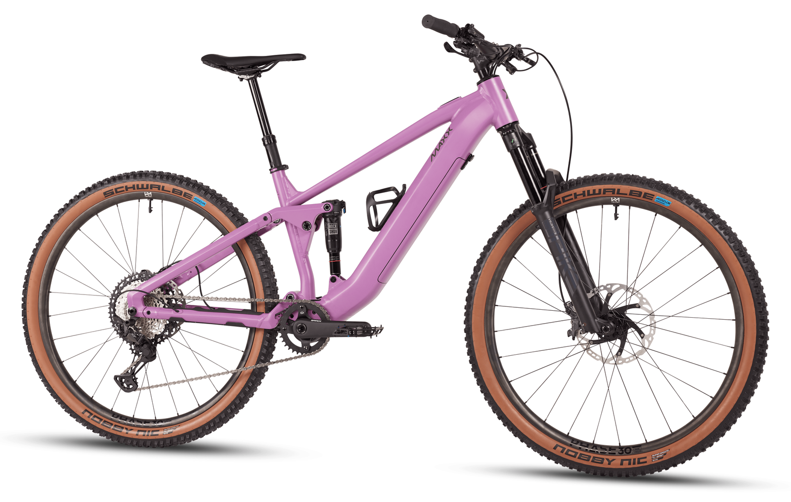

The MAXX Jinxx ELF 2026 is a German aluminium lightweight eMTB built around Fazua's Ride 60 drive, aimed at the rider who wants quiet, low-impact assist on a full-suspension trail platform. It runs 140 mm of fork travel and 130 mm rear, with a 430 Wh battery and a Fazua Ride 60 motor delivering 60 Nm of torque and 450 W peak. Headline geometry: a 66 degree head angle and a 443 to 505 mm reach range across four sizes, with size-specific chainstays ranging 445 to 461 mm. €4,999 for the single base trim. Community verdict: a niche but well-thought-out German lightweight that pairs the Ride 60's natural feel with a sensibly proportioned trail chassis at a sharp price.
Drive system and range. The Fazua Ride 60 is one of the cleanest-looking, most natural-feeling lightweight motors on the market. It delivers 60 Nm of torque and 450 W of peak power, sitting between the TQ HPR50 (50 Nm) and Bosch SX (55 Nm) on output. The motor itself weighs just 1.98 kg, which is meaningfully lighter than the Bosch CX Gen 5 (2.8 kg). The 430 Wh battery is on the smaller side of the lightweight class but is typical for Ride 60 platforms, with real-world range usually 35 to 60 km depending on terrain, rider weight and assist discipline. Fazua's Toolbox app handles firmware updates, including refinements to the Ride 60's mode behaviour and assist character that have steadily improved the system over its life.
Geometry and handling. A 66 degree head angle is on the conservative side for a 140 mm trail platform, half a degree steeper than the modern trail-bike norm. Reach grows from 443 mm in S to 505 mm in XL, a generous 62 mm spread that supports both shorter and taller riders. Chainstays grow from 445 mm in size S to 461 mm in M, L and XL, a size-specific approach that gives bigger riders proportional rear centres and is more sophisticated than the single-chainstay-across-all-sizes approach most rivals use. Wheelbases span 1197 to 1298 mm.
Build and value. One trim, €4,999. MAXX positions the Jinxx ELF at the value end of the Fazua Ride 60 trail eMTB market. The standout strengths are the aluminium chassis (genuinely repairable and cost-effective compared to carbon), the size-specific chainstay design and the proven Fazua drive system. The questionable note is the lack of detailed published component spec at this price step: buyers should confirm fork, shock, drivetrain and brake choices through MAXX dealers before commit. At €4,999 the Jinxx ELF undercuts most German lightweight rivals by €1,000 to €2,000, but on aluminium rather than carbon.
Caveats and known gripes. Fazua reliability has historically been a community concern, with previous-generation Fazua Evation systems flagged for failures and slow service responses. The Ride 60 is a meaningfully improved platform but still carries some of that reputational weight, especially against TQ and Bosch alternatives. The 430 Wh battery is small enough that all-day rides need range-extender support or careful mode management. MAXX dealer reach outside Germany is modest, which can complicate warranty and motor service for buyers elsewhere in Europe or the UK. And the 66 degree head angle, while sensible for the platform, limits aggressive descending compared to slacker-angle lightweight rivals like the Spectral:ONfly.
Verdict. The Jinxx ELF 2026 suits the lightweight eMTB buyer who values the Fazua Ride 60's natural feel on a sensibly proportioned aluminium trail chassis with size-specific chainstays, at the sharp end of the lightweight price band. Riders chasing carbon frames, larger batteries or wider UK dealer support should look at the Canyon Spectral:ONfly, the Trek Fuel EXe or the Specialized Levo SL. Production status: current.
