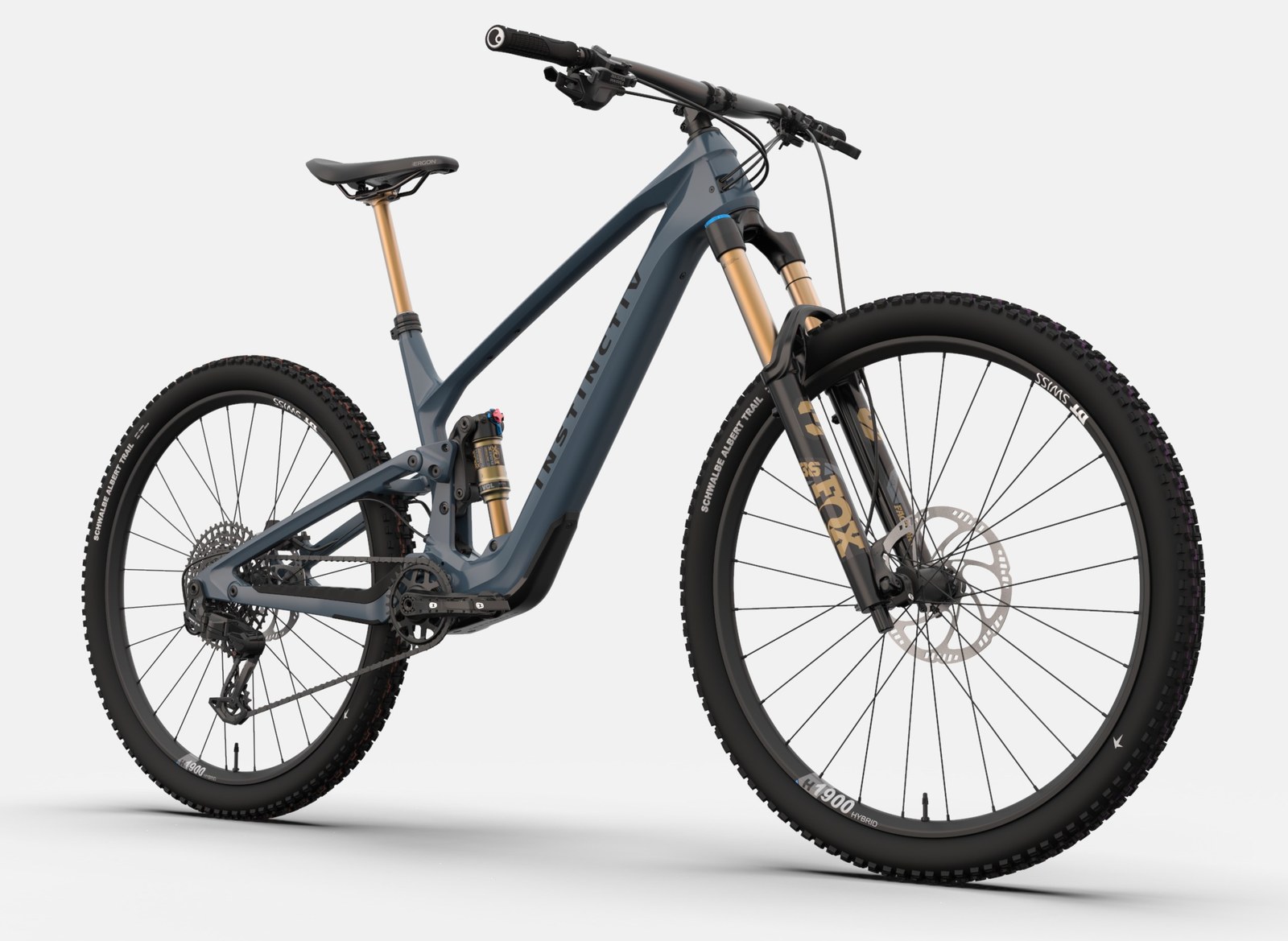

The Instinctiv Ocelot 125 2026 is a Swiss-engineered lightweight trail eMTB built around the Maxon BIKEDRIVE AIR S motor: 90 Nm of torque, 620 W peak, a 400 Wh built-in battery and a 2.0 kg unit weight. The Ocelot 125 pairs that drive system with 160 mm of fork travel and 125 mm out the back in Instinctiv's patented PUMA suspension layout, all wrapped in a 3.1 kg carbon frame. Total bike weight depending on spec runs 16.4–18.8 kg in size L without pedals — placing this firmly at the lightweight end of the segment and competitive with Specialized Levo SL Gen 2 or Orbea Rise. Pricing starts around €8,700.
Drive system and range. The Maxon AIR S is the standout technical story. At 2.0 kg unit weight with 90 Nm of torque and 620 W peak, the AIR S delivers a power-to-weight ratio few competitors can match in the lightweight class. 85% efficiency is high. The integrated 400 Wh battery is smaller than the 800 Wh full-power systems but typical for lightweight eMTBs, and gives a claimed 1,100–1,400 m of elevation gain in medium or boost support modes on a full charge — broadly comparable to a Specialized Turbo Levo SL or Orbea Rise on similar terrain. The Maxon is also one of the quietest motors on the market, which suits the bike's stealth-trail intent.
Geometry and handling. A 64.5 degree head angle is bang in the modern long-travel trail sweet spot. Reach progresses from 430 mm (S) through 455 mm (M) to 480 mm (L) across three sizes. The 445 mm chainstay is held constant across sizes — short for the 160/125 mm travel package, supporting the bike's playful, lightweight trail character. Wheelbase runs 1,206 mm to 1,265 mm. PUMA suspension is Instinctiv's patented layout, designed for high anti-squat and pedalling efficiency on lightweight platforms. Three sizes is the main fit caveat — riders below roughly 5'4" or above 6'2" should check geometry tables carefully.
Build and value. Only a base trim is listed at the gold level. A forum rider notes the Ocelot Maxon 90 starts around $8,500 USD for the base model, broadly in line with the €8,700 entry price. That puts it in serious money territory — comparable to Specialized Levo SL Gen 2 or Orbea Rise SL boutique configurations. The technical sell is the combination of Maxon motor exclusivity, sub-19 kg total weight and 160/125 mm travel. Build configuration is heavily customisable through the Instinctiv direct-order pipeline.
Community-verified strengths. Forum data is thin — the Ocelot is brand new and almost no bikes were in public circulation at the time of writing. @CoolWetGrass confirms the Ocelot 145 sibling uses the same Maxon AIR S 90 Nm motor at 16.8 kg claimed weight, with first bikes shipping Q1 2026. The lightweight construction (16.4–18.8 kg size L) is the headline practical strength. Maxon's industrial pedigree (precision drive motors for satellites, surgical robots and Formula 1) gives the brand technical credibility even in a market unfamiliar with their bike motors.
Caveats and known gripes. The 125 mm rear travel package is firmly trail-oriented; one forum rider directly notes that they would "want 170 mm" rather than 145 (let alone 125) — buyers wanting enduro-capability should look at the Ocelot 135 or 145 siblings instead, or different brands entirely. Maxon's bike-motor service network is essentially nonexistent outside specialist Swiss/European dealers; warranty and repair logistics are an unknown for most UK buyers. The 400 Wh built-in battery is non-removable and small for big-day riding without a range extender. No first-hand long-term ownership data exists on the forum. At €8,700 you are paying boutique premiums for technical exclusivity rather than mainstream value.
Verdict. The Instinctiv Ocelot 125 is one of the most technically interesting lightweight eMTBs launching in 2026: Swiss engineering, exclusive Maxon AIR S power, PUMA suspension and sub-19 kg total weights. It will suit riders who prioritise low weight, natural ride feel and stealth aesthetics over outright power or range, and who value early-adopter technical novelty. Buyers wanting proven service networks, longer travel, larger batteries or first-hand owner data should look at the Specialized Levo SL Gen 2 or Orbea Rise SL alternatives. Production status: current, with shipping commencing Q1 2026.
