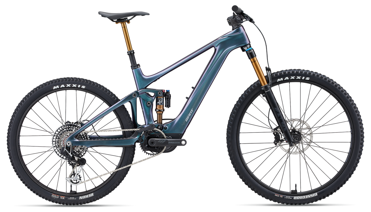

Trance X E+ 2025
SyncDrive Pro-powered mullet eMTB with 400Wh EnergyPak
The Giant Trance X E+ 2025 is Giant's flagship Maestro-suspension trail eMTB. Headline numbers: 150mm fork, 140mm rear, Giant SyncDrive Pro2 motor at 85Nm and 600W peak with a 2.75kg motor mass, a removable 400Wh Giant EnergyPak battery on the lighter (base) build at 18.8kg, with the Elite trim at GBP 5,499 listed at 23.5kg, 64.5 to 66.2 degree head angle in low/high settings and reach 422 to 515mm across twelve flip-chip-coded sizes. Community read: @Rando_12345 stresses that the Trance X E+ and Trance X E+ Elite are "completely different bikes" (like a Levo full-power versus a Levo SL).
