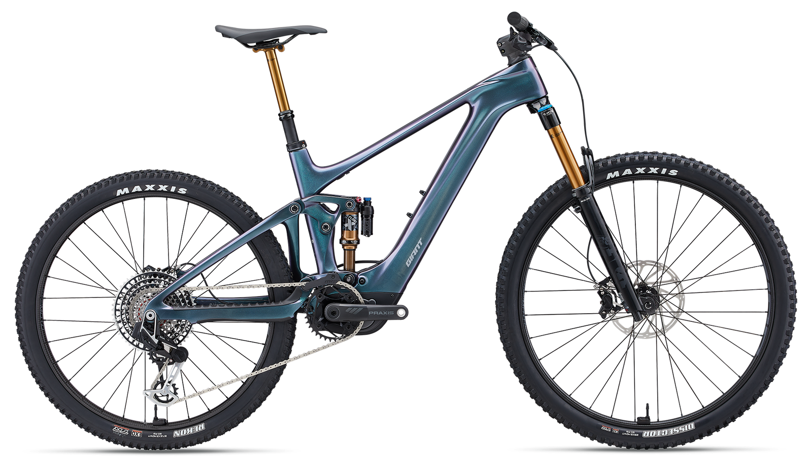

The Giant Trance X Advanced E+ 2025 is Giant's carbon lightweight eMTB, built around the SyncDrive Pro2 motor (Yamaha-co-developed, 85 Nm) and a relatively small 400 Wh integrated battery. Travel is 150 mm front and 140 mm rear via Giant's Maestro suspension, the bike runs mixed 29/27.5 mullet wheels, and at a claimed 19.5 kg in size L it sits firmly in the "light-but-not-the-lightest" eMTB pack. Headline price is £4,549 for the Elite 2 trim. The community verdict is positive overall on ride feel — @thebradjohns reports "smiles per mile today were up there" — although owners flag motor reliability concerns and the small battery as the main caveats.
Drive system and range. The SyncDrive Pro2 produces 85 Nm of torque and 600 W peak power, and the latest firmware has substantially refined the unit from the noisy 2022 generation — @glovemtb77 notes "Giant/Yamaha motors now much quieter than 2022 'meat grinder' noise." The headline compromise on this bike is the 400 Wh integrated battery — small by 2025 standards (Trek Fuel EXe runs 360 Wh, Specialized Levo SL 320 Wh, but full-power Bosch/Avinox rivals sit at 750-800 Wh). Range is roughly 800-1,100 m of climbing in trail mode. Compatibility note: @pwiles1968 confirms the new 2026 Reign E+ runs a different 48V architecture, so don't expect cross-platform battery swaps.
Geometry and handling. Eight effective size options — four frame sizes each in Low and High flip-chip positions — give head angles ranging from 65.4° to 66.2° and reach from 422 mm (SM Low) to 515 mm (XL High). Chainstays sit at 437-439 mm depending on flip-chip position. The Maestro suspension's Trunnion-mount FOX Float X piggyback shock gives a planted ride, and a 65.4° head angle in Low is properly modern-trail. @Ridemore confirms most riders end up running the Low setting after initial High-setup deliveries.
Build and value. The Elite 2 trim at £4,549 includes Fox 36 Performance Elite (LiveValve on higher-spec Elite 1 variants), Fox Float X Performance Elite shock, and the SyncDrive Pro2 with 400 Wh battery. Frame is carbon (Advanced grade), with alloy rear triangles on the Elite 3 variant per @Montana St Alum. The naming is famously confusing — Giant runs Advanced (full carbon), Advanced Pro and Elite numbering plus three-digit trims. Aftermarket weight-shedding is popular: @Ivan took his Trance Elite from 20.7 kg stock to 20.17 kg through tyre and component swaps.
Community-verified strengths. @Jurassic reports "approximately 4500 km on my 2022 E+1" with battery still at 94% capacity, motor and software fault-free, despite riding in wet Scottish conditions. @SteveTTT notes his KMC e12 chain lasted over 1,000 miles on a 2022 Trance X Advanced E+2, with the replacement gold chain still running smoothly past 0.75% stretch. Long-term durability gets generally positive marks once early-life niggles are sorted.
Caveats and known gripes. Rear-hub play is a known fault: @Yetibos details the fix — replace the spacer with the improved version stamped 'R', part 152C-M69REA-0001, a five-minute job. @waynegold1 reports motor failure with the "middle red light error" at around 1,500 miles / 18 months. @Jurassic had his frame crack above the motor (replaced promptly by Giant UK under warranty). The 400 Wh integrated battery is a clear weakness for long-day riders, with no removability and no published range extender route at time of writing.
Verdict. The Trance X Advanced E+ is for the rider who wants a carbon lightweight eMTB with Giant's strong dealer network at notably sharper money than a Levo SL or Trek Fuel EXe. It is not for big-day pedallers who need 600 Wh+ of energy, riders who can't tolerate motor event-code uncertainty, or buyers who want the latest Bosch/DJI ecosystem. Production status is current and the 2025 model continues in some markets alongside the new 2026 Reign E+.
