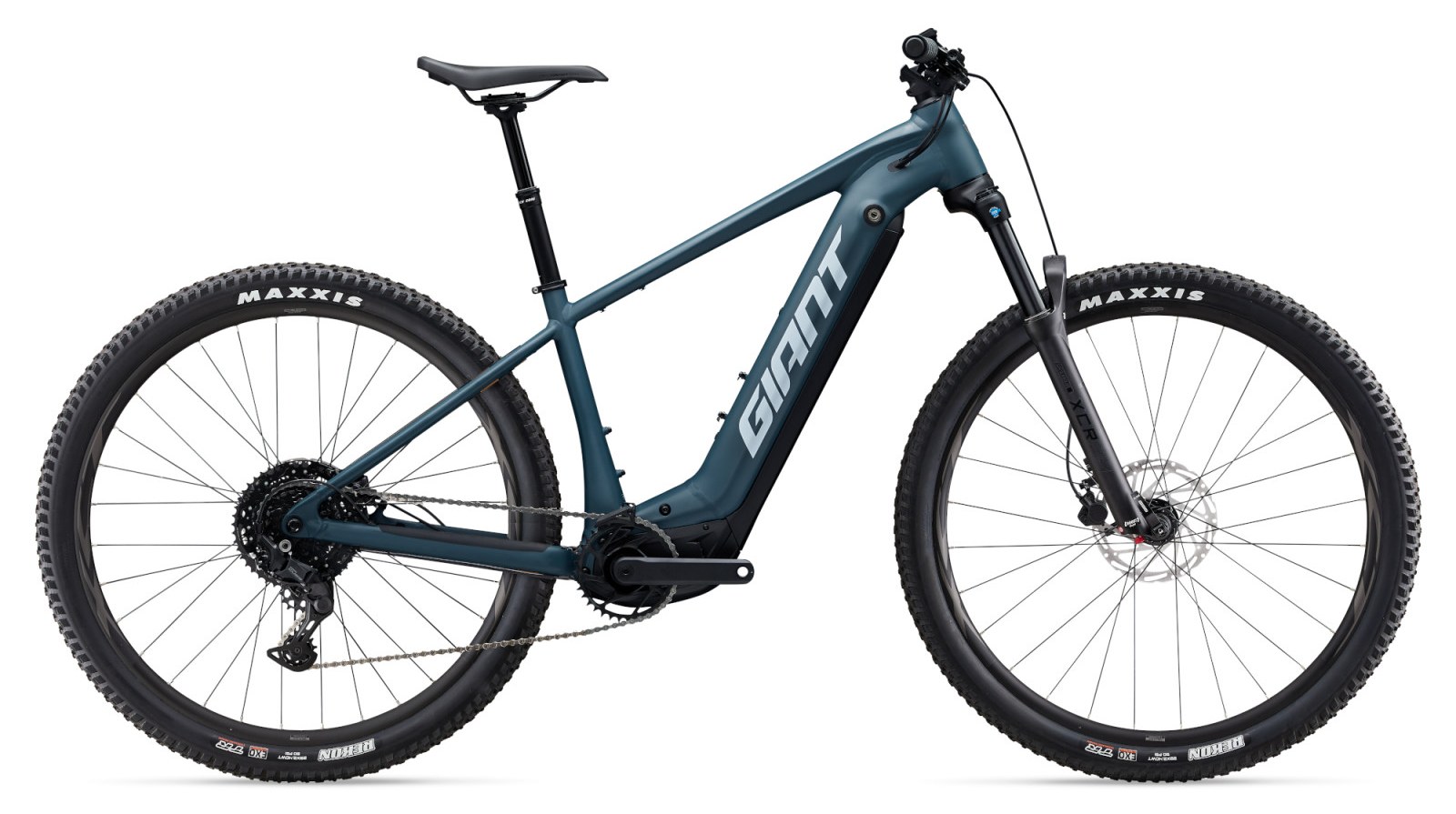

The Giant Fathom E+ 2026 is the Taiwanese giant's full-power aluminium hardtail eMTB and one of the cheapest credible routes into modern electric mountain biking. It is built around the Giant SyncDrive Pro2 motor (85 Nm, 250 W rated, 600 W peak, 2.75 kg) and a removable 800 Wh EnergyPak Smart battery. Travel is 120 mm at the fork only, the head angle is a moderate 66.0°, and the bike weighs a claimed 19.5 kg. UK base trim is just £2,999, putting it firmly in the value-hardtail conversation alongside the Cube Reaction Hybrid Pro and the Trek Powerfly. The community verdict is pragmatic: solid build, big battery, occasional motor event-code niggles to manage.
Drive system and range. The Giant SyncDrive Pro2 is co-developed with Yamaha (Yamaha PW-X3 underpins it) and produces 85 Nm of torque with 600 W peak power. The Smart Assist mode adapts power output to terrain by monitoring pedal force and incline, and rolling firmware updates have improved low-cadence response and refinement. The 800 Wh EnergyPak Smart battery is genuinely class-leading at this price — most rivals at sub-£3,000 ship 500-625 Wh packs. Expect 1,200-1,800 m of climbing on a charge depending on assist mode, with hardtail efficiency adding meaningfully to range on smoother trails. The pack is removable for off-bike charging.
Geometry and handling. A 66.0° head angle is squarely cross-country/trail and notably steeper than full-suspension trail eMTBs. Reach progresses SM 416 mm, MD 434 mm, LG 451 mm, XL 469 mm — a sensible 17-18 mm progression. Chainstay length is fixed at 470 mm across the range, which keeps weight rearward but suits the seated climbing-focused intent. Wheelbase grows from 1,197 mm on the SM to 1,262 mm on the XL. 29in wheels front and rear. The geometry is well-suited to fire-road exploration, gentle singletrack and bridleway commuting rather than aggressive descending — and that's exactly what this bike is for.
Build and value. The base trim at £2,999 includes the SyncDrive Pro2 motor, 800 Wh EnergyPak Smart battery, RideControl Ergo 2 display, and a Shimano-class drivetrain with hydraulic disc brakes. There is no full-suspension option in the Fathom E+ line — for that, Giant points buyers to the Stance E+ or Trance X E+ Pro. Notable absences: no carbon variant, no premium fork, and no Bluetooth/Smart System parity with rivals — the RideControl ecosystem is functional but more basic than Bosch Flow or Specialized Mission Control. Walking through the price ladder reveals a single-trim approach in 2026 spec.
Community-verified strengths. Long-term reliability has been positive for many owners: @DaveMatthews reports "I had a Fathom for 3 years with zero issues, and now my Stance trouble free for 3 years." The 800 Wh battery is the standout feature at this price — most direct rivals cap out at 625 Wh. Older Fathom E+ 3 firmware updates have continued to refine motor behaviour, with @Kiwi Giant noting an Auto Assist Mode firmware change that improved everyday usability.
Caveats and known gripes. The most-reported issue is SyncDrive "Event codes" — @ioanko describes the motor stopping mid-ride on a steep climb, with Giant's response being that "the codes you see are not necessarily error codes". @Joecrow pushes back: "the events codes would only be OK if you were not having problems!" Bottom line: when the motor actually shuts off, push hard for warranty support. @Kiwi Giant reports motor mount bolts requiring T-30 TorX and 22 ft-lbs retorque to fix creaking. @rik672001 had chain cracks within six weeks (warrantied). EU-spec bikes have the 25 km/h cutoff, which @Coughandcath finds frustrating on faster roads.
Verdict. The Fathom E+ is for the newcomer to eMTBs who wants Giant's dealer network, a serious 800 Wh battery and a robust aluminium hardtail at the cheapest realistic price point. It is not for technical descending, full-suspension comfort, or buyers who want the latest Bosch/DJI motor parity. Production is current and the bike is widely stocked at Giant dealerships globally.

Fathom E+ Deep Lake
£2,999
MotorGiant SyncDrive Pro2 · 85 Nm
BatteryGiant EnergyPak Smart 800 · 800 Wh
Travel F/R130/? mm
FrameAluminium
ForkSR Suntour XCR34 2CR coil boost 130mm travel 15x110mm AH axle
ShockNone (hardtail)
StemGiant Contact
HandlebarGiant Connect TR Riser 31.8x750mm [S], 780mm [M-XXL]
GripsGiant Sole-O
SaddleGiant Ergo Contact Trail, ESG
SeatpostGiant Contact Switch Core dropper seatpost, 100mm travel
BrakesShimano MT200, hydraulic disc, 180mm [F/R]
Rear derailleurShimano Cues 10-speed
CrankForged aluminium direct-mount chainring steel 36T, forged aluminium crank arms
ShiftersShimano Cues
CassetteShimano Cues 11-48T 10-speed
ChainShimano Linkglide CN-LG500
DrivetrainShimano Cues 10-speed; Giant SyncDrive Sport (75Nm), 750Wh EnergyPak Smart
WheelsGiant XCT 29 Tubeless Ready 25mm e-bike optimized rims, eTracker boost alloy 6-bolt disc hubs (15x110mm front / 12x148mm rear), stainless steel spokes
TyresMaxxis Rekon 29x2.4", EXO, 60TPI
Weight19.5 kg
