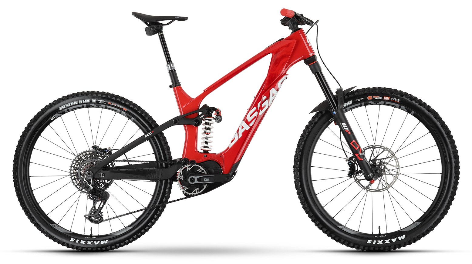

The GasGas ECC is the brand's full-carbon E-Enduro platform, built around 170mm of fork travel, 160mm at the rear and a race-focused 64 degree head angle across all three sizes. The SRAM Eagle Powertrain motor (90 Nm, 680 W peak) and integrated 630 Wh battery are shared across the whole range, so the difference between trims is purely suspension, drivetrain and brakes rather than drive system or geometry.
The ECC 6 at GBP 8,999 is the flagship: DVO Onyx OTT fork and JadeX coil shock, SRAM X0 Eagle Transmission, Code RSC brakes and a RockShox Reverb AXS dropper, with NEWMEN Evolution SL alloy wheels keeping claimed weight to 24.1 kg. The ECC 5 at GBP 7,999 keeps the same DVO suspension but drops to GX Transmission, G2 RS brakes and a cable dropper. The ECC 4 at GBP 6,499 is the value pick, swapping to a RockShox ZEB Select+ and Super Deluxe coil with mechanical GX Eagle and DB8 brakes, which makes it the most accessible way onto the identical race frame.
Geometry is long and slack with a steep 75 to 76 degree seat angle and size-specific 461 to 469mm chainstays, pointing squarely at fast, steep enduro terrain rather than mellow trail riding. All three trims share an identical frame and geometry table (sizes S/M/L, reach 450/475/500mm), so the trim number simply reflects the build kit, not the chassis.
