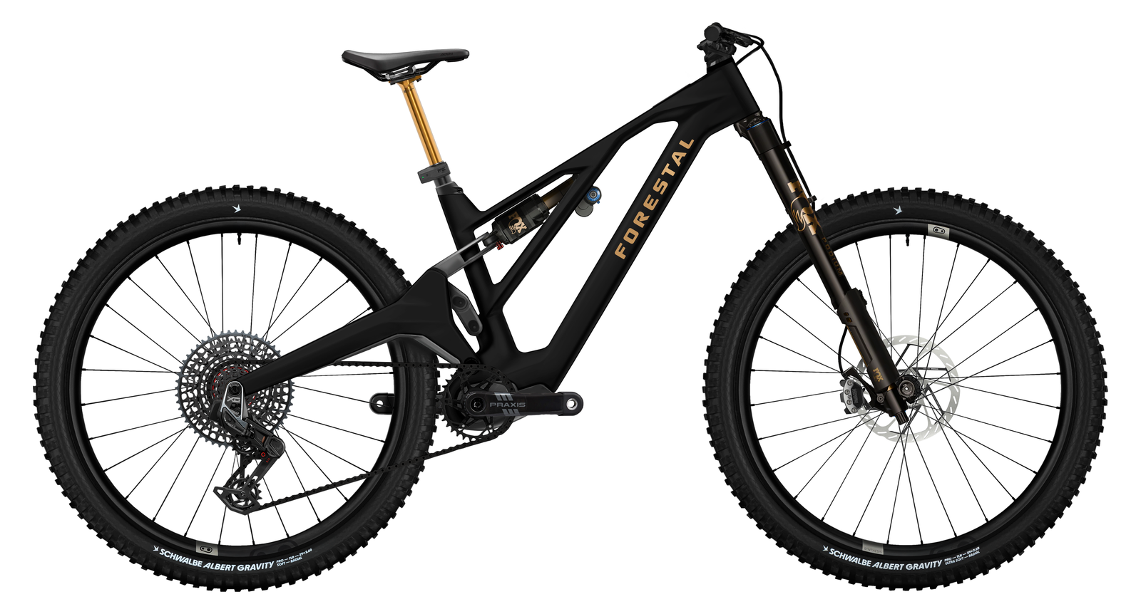

The Forestal e-Siryon V2 2026 is the reborn full-power version of the Andorran brand's flagship enduro eMTB, jumping from the smaller Aurora battery to the DJI Avinox M2S motor (150 Nm peak torque, 250 W rated, 1500 W manufacturer-claimed peak, 2.63 kg) and an 800 Wh Avinox FP800 battery. Travel is 170 mm front and 170 mm rear on Forestal's Alpha Box v2 carbon chassis with Twin Levity single-pivot multi-link suspension. Single Diode trim catalogued at £12,999, claimed weight 21.5 kg. Four size/configuration combinations from F2 to F3, reach 460-485 mm, head angle 64.0 degrees flat, chainstays 448-450 mm. The community read in one line: a properly bleeding-edge Andorran carbon enduro that pairs the most powerful production motor with sub-22 kg weight and 170/170 mm travel, with the trade-offs being premium pricing, the integrated battery and ongoing delivery slippage.
Drive system and range. The DJI Avinox M2S is the second-generation Avinox motor and currently the most powerful production eMTB drive: 150 Nm peak torque, 1500 W manufacturer-claimed peak. @Seb.NoLi confirmed via Forestal support that the e-Siryon V2 will ship with the new Avinox motor. The 800 Wh Avinox FP800 battery is the headline range improvement over Forestal's previous 360 Wh Aurora pack, but the frame notes still describe it as "integrated non-removable" so users will charge on the bike via a 65 W USB-C external port. Real-world range will sit in the 50 to 80 km territory on Trail/Boost mode.
Geometry and handling. Modern enduro. 64.0 degree head angle is bang on the enduro norm. Reach progresses 460 mm (F2 S/M) and 485 mm (F3 L). Chainstays size-tune subtly 448 mm (S/M) and 450 mm (L). Wheelbase 1254-1285 mm. The Twin Levity single-pivot multi-link suspension is Forestal's evolution from their first-generation Hydra/Cyon kinematics — designed to give the simplicity of single-pivot with the progressive feel of a multi-link. 29 inch wheels with mullet option.
Build and value. Single Diode trim catalogued at £12,999 (21.5 kg). Specs are RockShox ZEB Ultimate fork, Vivid Ultimate Air rear shock, SRAM Maven 4-piston brakes and SRAM Eagle AXS Transmission. The Halo trim (referenced in build descriptions) downgrades to ZEB Select, Vivid Select Air and SRAM Code brakes. Premium Andorran pricing reflects the bleeding-edge motor and carbon weight.

Verdict. The Forestal e-Siryon V2 2026 is one of the most ambitious carbon full-power enduro eMTB launches of the year — DJI Avinox M2S, sub-22 kg, 170/170 mm travel, and Forestal's improved second-generation carbon platform. It suits early-adopter riders who appreciate Andorran engineering, who can wait through extended delivery timelines, and who value the bleeding-edge spec at premium pricing. Look elsewhere if you need a bike soon (significant delays documented), if you want a removable battery, or if you need a wider size range. Production status: upcoming, single Diode trim, four size/config combinations, deliveries pushed to late 2026.
Frame
Forestal Alpha Box v2 monocoque full-carbon frame, Twin Levity 170mm single-pivot multi-link suspension, Avinox 800Wh integrated non-removable battery, 29-inch wheels (mullet option), 65W USB-C external charging port.
