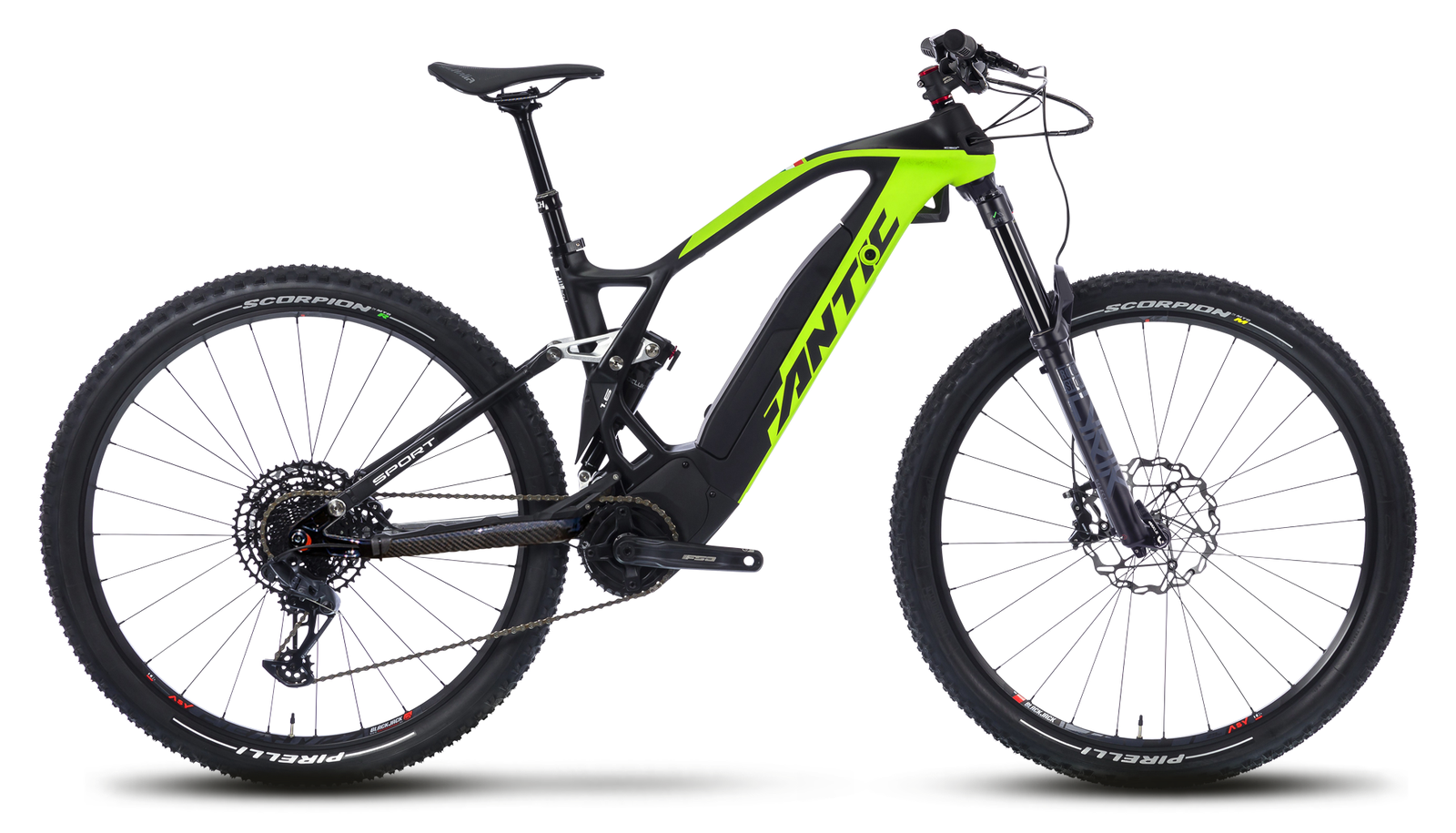

The XTF 1.6 is Fantic's full-power carbon trail eMTB, sold for 2026 in three builds off one frame: Carbon Sport (6,290 euros / 6,499 pounds), Carbon Race (9,390 euros / 7,999 pounds) and the range-topping Carbon Factory (12,990 euros / 10,999 pounds). Every build runs the Brose S Mag motor at 90Nm and a Fantic Integra 720Wh battery, with 160mm of travel front and rear on a carbon front triangle and carbon-reinforced alloy rear. Geometry is consistent across the range: a 66 to 67 degree head angle that steepens with size, a 73 degree seat angle, long 456mm chainstays and a fairly high 362.5mm bottom bracket.
The builds separate themselves cleanly. Sport runs a RockShox Lyrik Select+ fork, SRAM G2 RS brakes, alloy Rodi wheels and a mechanical GX/NX drivetrain. Race steps up to carbon FSA i29 wheels and SRAM GX AXS wireless shifting. Factory is the showpiece at a claimed 19.9kg, with a Lyrik Ultimate fork, Deluxe Ultimate shock, Magura MT Trail Carbon brakes, FSA KFX carbon wheels, SRAM XX1 AXS and a RockShox Reverb AXS wireless dropper.
Worth knowing: the live store spec pages omit brakes, wheels, tyres, saddle and dropper, so those items here are carried from UK Fantic retailer listings of the same builds and should be treated as such. There is little owner feedback on the current XTF 1.6 in the community yet, so no real-world reliability picture exists.
