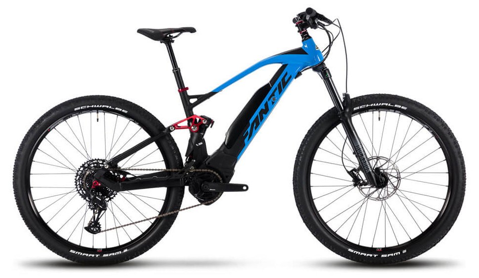

The 2022 Fantic XTF 1.5 was the alloy entry point into the Italian brand's XTF trail range, built on a hydroformed aluminium frame with 150mm of travel front and rear via Fantic's full-float linkage-driven single-pivot rear end. It rolled on 29in wheels at both ends and was offered in three sizes (S, M, L).
Power came from a Fantic-rebadged Brose mid-drive, listed on the page as Brose ALU 36 Volt, 250W and 90Nm, fed by an integrated 630Wh Fantic Integra battery and controlled through the Brose All Round 4 display. The build is deliberately utilitarian: a RockShox Recon Silver RL fork and Deluxe Select air shock, a full SRAM SX Eagle 12-speed transmission, SRAM Level 2-piston brakes on 200mm front / 180mm rear CenterLine rotors, and chunky Schwalbe Smart Sam 29 x 2.6in tyres on Rodi BlackJack rims, finished with a Promax cockpit and dropper post.
Geometry is moderate trail rather than aggressive enduro, with a 66 to 66.5 degree head angle, a 73 degree seat angle and reach growing from 407mm (S) to 453mm (L). Within the wider 2022 XTF 1.5 line it sat below the higher-specced alloy XTF 1.5 Sport and the four separate carbon models (Carbon, Carbon Sport, Carbon Race and Carbon Factory), positioning itself as the value-focused, mid-power alloy trail option.

Geometry read
Size
Descending
58
A solid all-round descender (66.5° head angle, 150mm) — capable in the rough and steep without being an all-out bruiser.
Playfulness
33
More planted than poppy — better on steep terrain than tight, fiddly singletrack.
Size balance
68
Rear-long with a planted front in L (FC:RC 1.64) — easy to weight the front and quick to turn, though it can feel light at the back at real speed.
Technical climbing
74
Brose Drive S Mag and a steep 73° seat angle keep the weight planted over the front — a proper winch. 560W of peak power and 90Nm of torque — a strong full-power motor.
Best suited toBig-day all-rounders who climb a lot and still descend hard.
Strong up and composed down — a do-it-all, not a specialist.
Watch out forNot a flickable, playful bike — built to plough, not pop.
Brilliant on fast, rough, steep terrain; less fun on tight, mellow trails.
