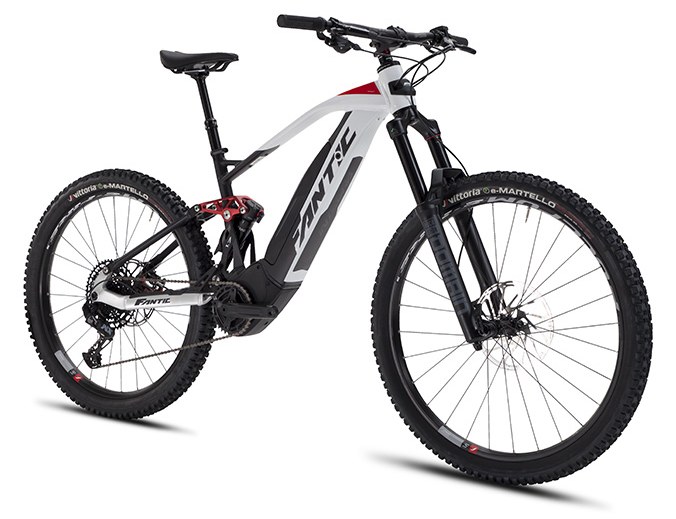

Fantic XMF 1.7 2023
From £4,999
EMTB Forums verdict
The 2023 Fantic XMF 1.7 was the aluminium, full-power member of Fantic's all-mountain XMF line. It ran a mullet wheel layout (29in front, 27.5in rear) with 170mm of travel at both ends, a slack 65-degree head angle and a 73-degree seat angle, which is firmly enduro-leaning geometry for a bike Fantic still pitched as a trail-handling all-rounder.
Power came from the Brose-based Fantic full-power unit, a Brose S-MAG rated at 90Nm and 250W nominal, fed by an integrated 720Wh battery for genuinely long-day range. The single Sport build paired a RockShox Domain-R fork and Deluxe Select+ shock with a SRAM NX Eagle 12-speed drivetrain, four-piston SRAM Guide T brakes on 220/203mm rotors, Fulcrum E-700 wheels and Vittoria E-Martello tyres, a sensible, hard-wearing all-mountain kit rather than a boutique parts list.
It was offered in three sizes (S, M, L) with reach from 425 to 480mm. This is a discontinued 2023 model; Fantic has since moved the XMF on to the newer Integra-era platforms, so availability is now limited to remaining dealer stock and the used market. UK pricing was around £4,999 RRP for the Sport.

MotorBrose Drive S Mag · 90 Nm
BatteryFantic Integra 720Wh · 720 Wh
Travel F/R170/170 mm
FrameAluminium
ForkRockShox DOMAIN-R e-bike 29" 170mm
ShockRockShox Deluxe Select+ T205x60 Air
StemFSA Comet, 35mm clamp, +6 degrees, 50mm
HandlebarFSA Comet, 35mm clamp, 15mm rise, 800mm width
SaddleSelle Italia X-Bow Comfort Superflow 145
SeatpostSwitch SW dropper, 30.9mm, S-M 100mm / L 125mm
BrakesSRAM Guide T 4-piston hydraulic disc (front and rear). Rotors: Braking S3 Battfly 220mm front / 203mm rear, 6-hole.
Rear derailleurSRAM NX Eagle 12-speed
CrankFSA CK-7462/IS 165mm with SRAM 34t Steel Eagle chainring
ShiftersSRAM NX E-click
CassetteSRAM SX Eagle 12-speed, 11-50
ChainSRAM SX Eagle 12-speed
DrivetrainSRAM NX Eagle 12-speed; FSA CK-7462/IS 165mm with SRAM 34t Steel Eagle chainring; SRAM NX E-click; SRAM SX Eagle 12-speed, 11-50; SRAM SX Eagle 12-speed
WheelsFulcrum E-700 wheels
TyresVittoria E-Martello, front 29"x2.35 / rear 27.5"x2.6
