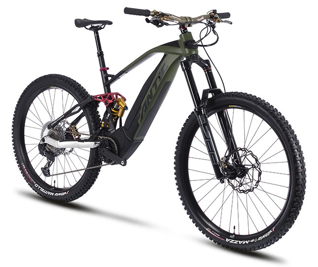

The Fantic XEF 1.9 was the flagship of the Italian brand's 2023 Integra enduro range: a 190mm-travel alloy mullet (29in front, 27.5in rear) eMTB built around the Brose Drive S Mag 90Nm motor and a 720Wh Integra battery. Geometry is long and slack for the era, with a 64.5deg head angle, 469mm reach and 459mm chainstays on the Large.
Two builds were sold. The Factory headlined with a RockShox ZEB Ultimate fork, Ohlins TTX coil shock and Sram GX-AXS wireless shifting, with a UK price of around £8,499. The Race undercut it at roughly £6,699 using a ZEB Select fork, RockShox Super Deluxe Coil shock, Magura MT7 brakes and a wired Sram GX drivetrain. Both ran Mavic E-Deemax wheels and Vittoria E-Mazza/E-Martello rubber.
This model is discontinued, superseded by later XEF 1.9 versions for 2024 and the XEF 1.9 Factory for 2025. Fantic published actual seat tube angle and a letter-coded geometry chart rather than effective figures, so some derived numbers are cross-referenced.
