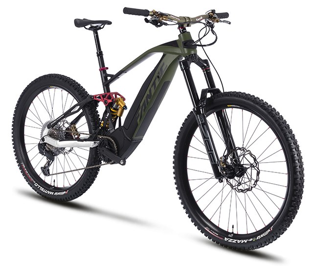

The 2022 Fantic XEF 1.9 was the Italian brand's flagship enduro eMTB: a 190mm-travel mullet (29in front, 27.5in rear) machine built on an aluminium frame around the Brose S-Mag 90Nm motor and a 720Wh Integra battery. Geometry is long and slack for the period, with a 64.5deg head angle, 469mm reach and fixed 459mm chainstays on the Large, and a notably low 364mm BB height across all sizes.
Two builds were offered, both in sizes S, M and L. The Factory was the halo model, distinguished by carbon seat stays and topped with a RockShox ZEB Ultimate fork, an Ohlins TTX coil shock, Sram GX-AXS wireless shifting and Renthal cockpit, at a recommended €8,990. The Race undercut it at €6,490 with a ZEB Select fork, RockShox Super Deluxe Coil shock, Magura MT7 four-piston brakes, wired Sram GX and FSA finishing kit. Both shared Mavic E-Deemax wheels, Vittoria E-Mazza/E-Martello rubber, a RockShox Reverb dropper and Braking S3 Battfly 220/203mm rotors.
