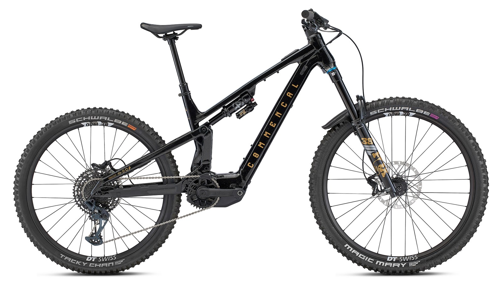

Aluminium DJI Avinox-powered enduro eMTB
The Commencal Meta Power 2025 is an aluminium mullet e-enduro built around the DJI Avinox M1 motor and a removable 800Wh battery. Headline numbers: 170mm fork, 160mm rear, 105Nm and a 1000W peak from the 2.52kg M1, 22.4kg claimed at the Signature trim, 64.0 degree head angle and reach 440 to 515mm across S to XL. From GBP 7,995 for the Signature build. Community read is that the Avinox-Commencal pairing is one of the standout enduro launches of 2025, with @bighungry34 calling the DJI drive unit "just next level" after migrating from a SRAM-powered Ekano.
Drive system and range. The DJI Avinox M1 is the most powerful production eMTB motor on the market in 2025, with 105Nm at the crank and a 1000W peak that Avinox can sustain longer than any rival thanks to large gearbox surface area and aggressive thermal mapping. The 800Wh FP800 battery is removable for storage and travel. @bighungry34 upgraded brakes (TRP DH-R EVO Pro), fork (RockShox ZEB) and wheels but kept the motor stock, reporting agile, poppy handling and unprecedented shove. The integrated touchscreen top-tube display, anti-theft alarm and 4G/GPS are stock features inherited from the Avinox ecosystem.
Geometry and handling. 64.0 degrees up front is genuine enduro territory and 5mm slacker than the Meta Power's old EP8 frame. Reach steps cleanly: 440 (S), 465 (M), 490 (L), 515 (XL). Chainstays are a uniform 460mm and wheelbase tops out at 1340mm on XL. The mullet wheel setup (29 front, 27.5 rear) and 460mm rear centre keep cornering surprisingly snappy for a 22.4kg long-travel bike. Older Meta Power riders such as @Tamas called the previous platform a "nimble tank, an absolute beast up and down" and the 2025 geometry sharpens that further.
Build and value. One frame, three suspension tiers. Signature (GBP 7,995, 22.4kg) gets FOX 36 Factory and Float X Factory, Shimano XT 4-piston brakes and SRAM GX Eagle T-Type AXS. Above that the Podium trim runs FOX Podium Factory Grip X2, Float X2 Factory and SRAM X0 T-Type AXS. Below, the Essential build steps down to FOX Performance suspension, TRP DH-R EVO Pro brakes and SRAM Eagle 90 T-Type mechanical. The 22.4kg system weight with a 800Wh battery is the headline: very few full-power enduro bikes come this light in alloy.
