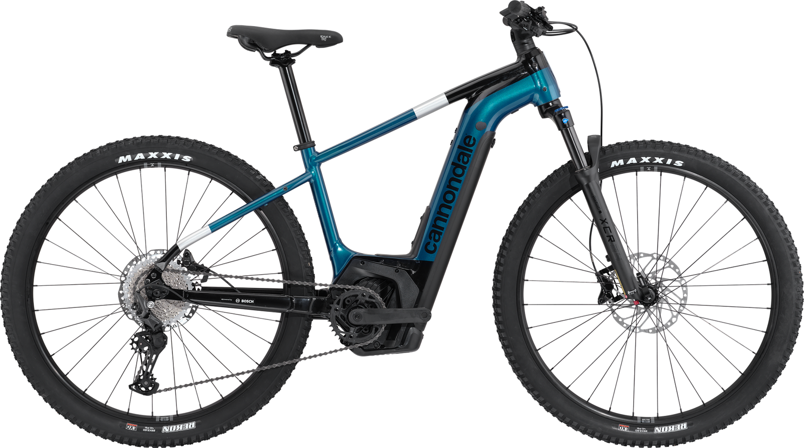

Cannondale
Trail Neo 2025
Current✎Electric hardtail mountain bike (cross-country / trail)Ageing · 4.7/10iFreshness 4.7/10
Motor
Bosch Performance Line CX Gen 4 · 85Nm · 600W
Battery
Bosch PowerTube 625 · 625Wh
Travel F/R
100/?mm
Wheels
MX (29F / 27.5R)✎
Frame
Aluminium
Price
From £3,000
From £3,000
| S | M | L | XL | |
| Reach | 405 mm | 420 mm | 450 mm | 480 mm |
| Stack | 625 mm | 625 mm | 634 mm | 643 mm |
| Seattube | 400 mm | 435 mm | 470 mm | 500 mm |
| Chainstay | 470 mm | 470 mm | 470 mm | 470 mm |
| Headtube Angle | 67° | 67° | 67° | 67° |
| Seattube Angle (eff) | 74° | 74° | 74° | 74° |
| BB Drop | 65 mm | 65 mm | 65 mm | 65 mm |
| Wheelbase | 1163 mm | 1178 mm | 1213 mm | 1246 mm |
| Standover | 750 mm | 750 mm | 758 mm | 756 mm |
| Front Centre | 693 mm* | 708 mm* | 743 mm* | 776 mm* |
