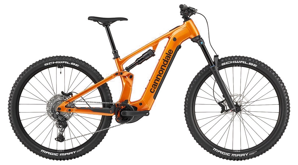

Moterra 2025
Alloy entry trim with 600Wh battery
The Cannondale Moterra 2025 is the full-power, all-mountain pillar of Cannondale's eMTB line, rebuilt around the Bosch Performance Line CX Gen 5 motor (120 Nm post-PU2.0, 750 W manufacturer-claimed peak, 2.8 kg). Travel is 160 mm front and 150 mm rear on a carbon front / alloy rear chassis with Proportional Response size-tuned suspension. Six trims from £4,499 to over £8,000, seven sizes from SM to XL, reach 430 to 515 mm, head angle 64.0 to 64.4 degrees, 600 Wh PowerTube on the base trim. Claimed weight 25.2 kg. The community read: a properly capable all-mountain platform with the best motor in the business, but it's heavy and a few support details (range extender compatibility, motor longevity) need careful dealer setup.

Frame
Moterra Carbon (1/2 tier) or SmartForm C1 Alloy (3/4 tier) full-suspension chassis, 29 inch wheels, 150mm rear/160mm front travel, Proportional Response size-tuned suspension, removable downtube battery, internal cable routing.

Trims · 5
4 £4,499 | 3 £5,499 | 2 £6,499 | 1 £7,999 | Carbon 1 | |
| Motor | Bosch Performance Line CX Gen 5 · 120 Nm · all trims | ||||
| Battery | Bosch PowerTube 800 · 600 Wh · all trims | ||||
| Travel F/R | 160/150 mm · all trims | ||||
| Frame | carbon front / alloy rear · all trims | ||||
| Fork | SR Suntour Zeron 36-X Boost, 160mm, EQ Air, compression & rebound adjust, 15x110mm thru-axle | RockShox Psylo Silver RC, 160mm, Motion Control, SoloAir, 15x110mm Maxle, tapered steerer, 44mm offset | RockShox ZEB Select, 160mm, Charger RC, DebonAir+, 15x110mm Maxle, 44mm offset | Fox Float Factory 38, 160mm, GripX2 Damper, Kashima coating, 15x110mm Kabolt thru-axle | RockShox Lyrik Select+, 150mm, DebonAir, 15x110mm thru-axle, tapered steered, 44mm offset |
| Shock | RockShox Deluxe Select, DebonAir+, adjustable rebound, 230x62.5mm | RockShox Deluxe Select, DebonAir+, adjustable rebound, 230x62.5mm | RockShox Deluxe Select+, DebonAir+, 2-Pos mode adjust, adjustable rebound, 230x62.5mm | Fox Float X Factory, Kashima coating, 2 pos adj, EVOL LV, 230x62.5mm | RockShox Deluxe Select+, DebonAir, 2-Pos mode adjust, adjustable rebound |
| Headset | Acros ICR, sealed bearings | Acros ICR, sealed bearings | Acros ICR, 1.5" to 1.8", sealed bearings | Acros ICR, 1.5" to 1.8", sealed bearings | — |
| Stem | Cannondale 1, 6061 Alloy, 35.0, 40mm, 0° | Cannondale 1, 6061 Alloy, 35.0, 40mm, 0° | Cannondale Trail HeadsUp w/ integrated display mount, 45mm, 0° | Cannondale Trail HeadsUp w/ integrated display mount, 3D Forged 6061 Alloy, 45mm, 0° | Cannondale 2, 6061 Alloy, 35mm, 0° |
| Handlebar | Cannondale 3 riser, 6061 Alloy, 25mm rise, 8° sweep, 4° rise, 800mm | Cannondale 3 riser, 6061 Alloy, 25mm rise, 8° sweep, 4° rise, 800mm | Cannondale 3 riser, 6061 Alloy, 25mm rise, 8° sweep, 800mm | HollowGram SAVE riser bar, Carbon, 35mm clamp, 30mm rise, 8° sweep, 780mm | HollowGram SAVE riser bar, Carbon, 35mm clamp, 30mm rise, 8° sweep |
| Grips | Cannondale TaperRidge | Cannondale TaperRidge | Cannondale TaperRidge | Cannondale TaperRidge | — |
| Saddle | WTB Silverado Medium | WTB Silverado Medium | Fizik Terra Ridon X5, 145mm | Fizik Terra Ridon X5, 145mm, Wingflex, S-Alloy Mobius rail | Fabric Scoop Shallow Elite, cro-mo rails |
| Seatpost | Cannondale DownLow dropper | Cannondale DownLow Dropper, internal routing, 34.9, 150mm (S), 170mm (M), 200mm (L), 230mm (XL) | Cannondale DownLow Dropper, 34.9, 150mm (S) to 230mm (XL) | Cannondale DownLow Dropper, internal routing, 34.9, 150mm (S), 170mm (M), 200mm (L), 230mm (XL) | Cannondale DownLow Dropper, internal routing, 31.6, 125mm (S), 150mm (M), 170mm (L-XL) |
| Brakes | Tektro Gemini SL | Shimano MT520 | Magura MT5 | Magura MT7 | Shimano XT 8120 |
| Rear derailleur | Shimano CUES U6000, LinkGlide | Shimano CUES U6000, LinkGlide | Shimano XT M8130, LinkGlide | SRAM XO Eagle AXS, T-Type | Shimano XTR |
| Crank | FSA Bosch E-bike w/ 55mm chainline, 160mm, 34T | FSA Bosch E-bike w/ 55mm chainline, 160mm, 34T | FSA Bosch E-bike w/ 55mm chainline, 160mm, 34T | e*thirteen e*spec Helix Core, 55mm chainline, 160mm, 34T | FSA Bosch E-bike w/ 55mm chainline, 160mm, 34T |
| Shifters | Shimano CUES U6000, 11-speed, LinkGlide | Shimano CUES U6000, 11-speed, LinkGlide | Shimano CUES U8000, 11-speed, LinkGlide | SRAM Eagle AXS T-Type Pod Controller | Shimano XT, 12-speed |
| Cassette | Shimano CUES LG400, LinkGlide, 11-50, 11-speed | Shimano CUES LG400, LinkGlide, 11-50, 11-speed | Shimano CUES LG700, LinkGlide, 11-50, 11-speed | SRAM GX Eagle T-Type, 10-52, 12-speed | Shimano XT, 10-51, 12-speed |
| Chain | Shimano LG500, LinkGlide, 11-speed | Shimano LG500, LinkGlide, 11-speed | Shimano LG500, LinkGlide, 11-speed | SRAM GX T-Type, 12-speed | Shimano XT, 12-speed |
| Drivetrain | Shimano CUES U6000, LinkGlide; FSA Bosch E-bike w/ 55mm chainline, 160mm, 34T; Shimano CUES U6000, 11-speed, LinkGlide; Shimano CUES LG400, LinkGlide, 11-50, 11-speed; Shimano LG500, LinkGlide, 11-speed | Shimano CUES U6000, LinkGlide; FSA Bosch E-bike w/ 55mm chainline, 160mm, 34T; Shimano CUES U6000, 11-speed, LinkGlide; Shimano CUES LG400, LinkGlide, 11-50, 11-speed; Shimano LG500, LinkGlide, 11-speed | Shimano XT M8130, LinkGlide; FSA Bosch E-bike w/ 55mm chainline, 160mm, 34T; Shimano CUES U8000, 11-speed, LinkGlide; Shimano CUES LG700, LinkGlide, 11-50, 11-speed; Shimano LG500, LinkGlide, 11-speed | SRAM XO Eagle AXS, T-Type; e*thirteen e*spec Helix Core, 55mm chainline, 160mm, 34T; SRAM Eagle AXS T-Type Pod Controller; SRAM GX Eagle T-Type, 10-52, 12-speed; SRAM GX T-Type, 12-speed | Shimano XTR; FSA Bosch E-bike w/ 55mm chainline, 160mm, 34T; Shimano XT, 12-speed; Shimano XT, 10-51, 12-speed; Shimano XT, 12-speed |
| Wheels | WTB ST i30 TCS rims, 30mm inner width, 32h, tubeless compatible; Shimano TC500 hubs (F: 15x110mm Boost, R: 12x148mm Boost) | WTB ST i30 TCS rims, 30mm inner width, 32h, tubeless compatible; Shimano TC500 hubs (F: 15x110mm Boost, R: 12x148mm Boost) | WTB ST i30 Tough TCS rims, 30mm inner width, 32h, tubeless compatible; Shimano TC500 hubs (F: 15x110mm, R: 12x148mm, centerlock) | Reserve 30|HD AL rims, 30mm inner width, tubeless ready; DT Swiss 370 front hub (15x110mm), DT Swiss 370 LN Ratchet System rear hub (12x148mm, 6-bolt) | WTB KOM Trail i30 TCS, 32h, tubeless ready |
| Tyres | Schwalbe Magic Mary Performance, 29x2.4", Addix Foldable, TLR | (F) Continental Kryptotal-F, 29x2.4", Enduro Soft Black Foldable / (R) Continental Kryptotal-R, 29x2.4", Enduro Soft Black Foldable | Continental Kryptotal-F/R, 29x2.4", Enduro Soft Black Foldable | Continental Kryptotal-F, 29x2.4", Enduro Soft Black Foldable (front); Continental Kryptotal-R, 29x2.4", Enduro Soft Black Foldable (rear) | (F) Maxxis Minion DHF, 29x2.6", EXO, tubeless ready / (R) Maxxis Rekon, 29x2.6" (27.5x2.6" - size Small), EXO |
| Price | £4,499 | £5,499 | £6,499 | £7,999 | — |
