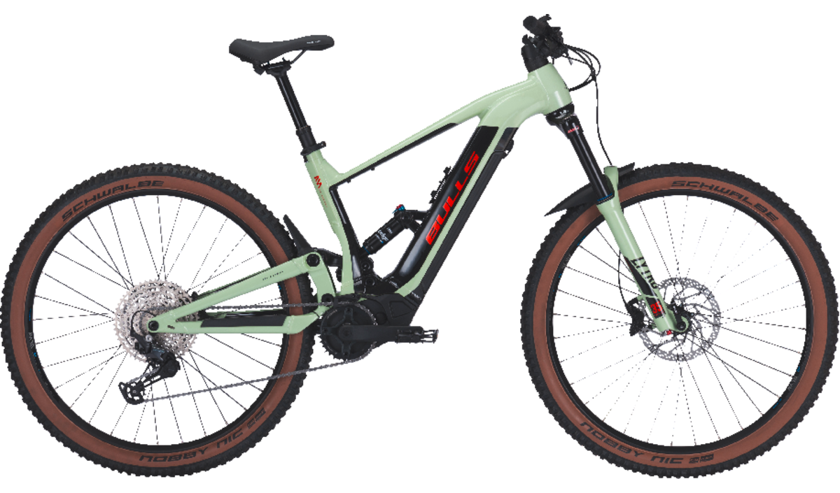

A solid all-round descender (66° head angle, 150mm) — capable in the rough and steep without being an all-out bruiser.
E-Stream EVO AM 2022
The 2022 Bulls E-Stream EVO AM was the marque's aluminium 150mm all-mountain e-bike, built around the headline FIT swappable-battery system that let buyers pick a 555, 720 or 925Wh UltraCore pack on the same Brose Drive S Mag motor. With a 66-degree head angle, 75-degree seat angle and 444 to 486mm reach across four sizes, the geometry was middle-of-the-road for the era rather than radical, leaning towards composed, all-day touring on 29in wheels.
The range climbed from the Deore-equipped AM 2 with a Suntour-based fork at 4,799 euros to the flagship AM 6 with a Fox 38 Factory fork, Float X Factory shock, XTR rear mech, DT Swiss wheels and Maxxis Minion tyres at 7,699 euros. Mid-trims mixed RockShox and Fox damping; the AM 4 paired a RockShox Lyrik Select fork with a Fox DPS shock. All trims ran a 203mm front rotor and Shimano four-piston braking, and the standard pack shipped on every trim was the 555Wh FIT UltraCore.
This bike is discontinued. Bulls replaced the alloy E-Stream EVO AM with later Sonic and VUCA all-mountain platforms, so it is now only available used. Spare FIT batteries and Brose service parts remain the main ownership considerations.
More planted than poppy — better on steep terrain than tight, fiddly singletrack.
Rear-long with a planted front in L (FC:RC 1.73) — easy to weight the front and quick to turn, though it can feel light at the back at real speed.
Brose Drive S Mag and a steep 75° seat angle keep the weight planted over the front — a proper winch. 560W of peak power and 90Nm of torque — a strong full-power motor.
Brilliant on fast, rough, steep terrain; less fun on tight, mellow trails.
