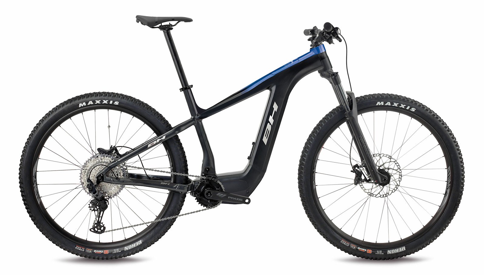

The BH AtomX Pro (product code ER622) was BH's flagship aluminium hardtail in the 2022 e-MTB Sport range, sitting a clear step above the entry-level Atom 29. Crucially it does not share that bike's budget in-house drive: the AtomX Pro runs the full-power Brose Drive S Mag mid-drive (the same motor family as BH's AtomX Lynx full-suspension bikes) fed by a 720Wh integrated battery, with BH claiming up to 155 km of range.
Geometry is conservative trail-hardtail rather than aggressive: a 69 degree head angle, 74.5 degree seat angle and 470mm chainstays across all four sizes, with reach growing from 420mm (S) to 465mm (XL). The build is sensible mid-range for the money: a 100mm RockShox Judy Silver fork, a 1x12 Shimano Deore drivetrain, Shimano MT420 four-piston brakes on 203mm rotors front and rear, Race Face AR30 wheels and 2.4in Maxxis Rekon trail tyres. There is no dropper post fitted as standard.
At an RRP of GBP 4,299.90 it was a premium price for a hardtail, justified almost entirely by the full-power Brose motor and large battery rather than the rolling chassis. It has since been discontinued; BH's current hardtail e-MTB range moved to the iLynx platform.

Geometry read
Size
Descending
45
A solid all-round descender (69° head angle, 100mm) — capable in the rough and steep without being an all-out bruiser.
Playfulness
37
More planted than poppy — better on steep terrain than tight, fiddly singletrack.

Bike geometry diagram
SMLXL
Reach420 mm435 mm455 mm465 mm
Stack608 mm617 mm627 mm645 mm
Seattube420 mm450 mm480 mm510 mm
Chainstay470 mm470 mm470 mm470 mm
Headtube Angle69°69°69°69°
Seattube Angle (eff)74.5°74.5°74.5°74.5°
Headtube100 mm110 mm120 mm140 mm
BB Height315 mm315 mm315 mm315 mm
