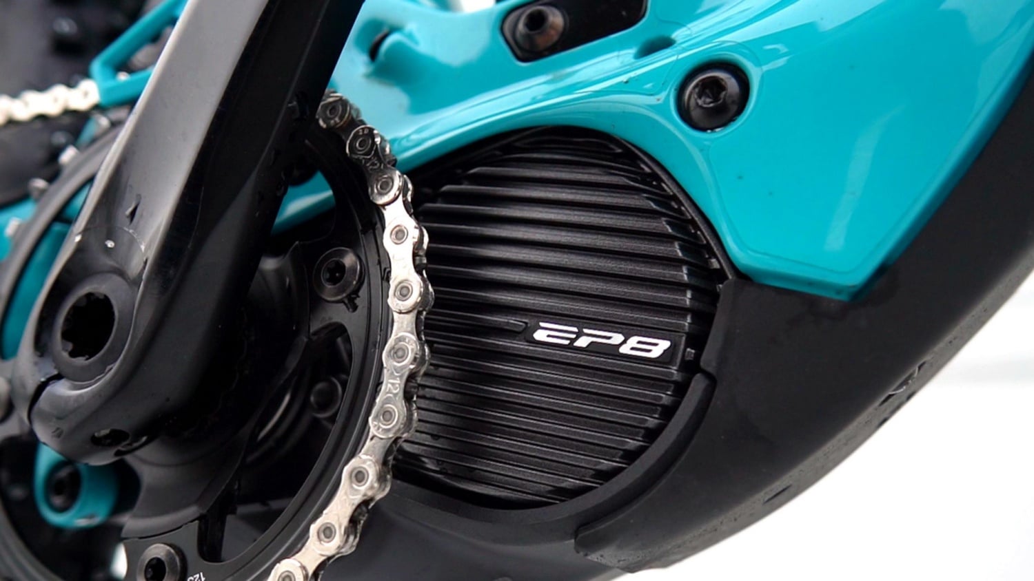

Bolt pattern is the same on the new motor, making it an easy fot on this bike. But there is some space between the motor andre frame, as shown in the image above. This space is not there with the EP800. It indicates that while the new motor looks similar, the shape is slightly different.
