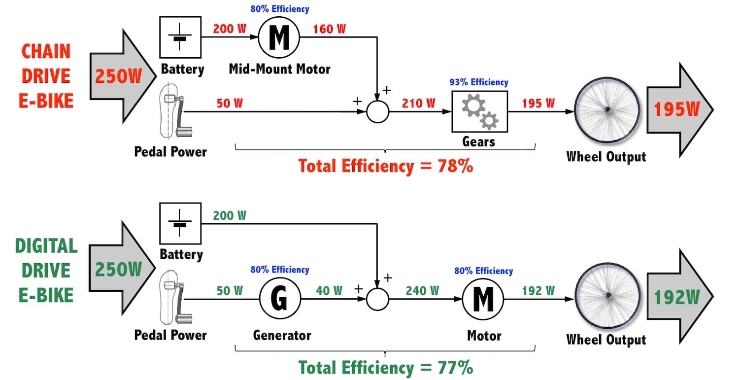

How about a chainless "Digital Drive" system ? We like motors !
At the crank you have a generator, this then transmits your power to a motor in the hub.
For example : Schaeffler’s Free Drive system
In terms of practicality for EMTB use, how would this work ? Probably not that well. For starters, there would be no gearing and the hub motor would need to provide the same power as an existing EMTB hub motor plus the extra power generated by the rider - meaning it would be larger and heavier. For people using EMTB's in flatter areas or for rugged commuting, it still might be an option.

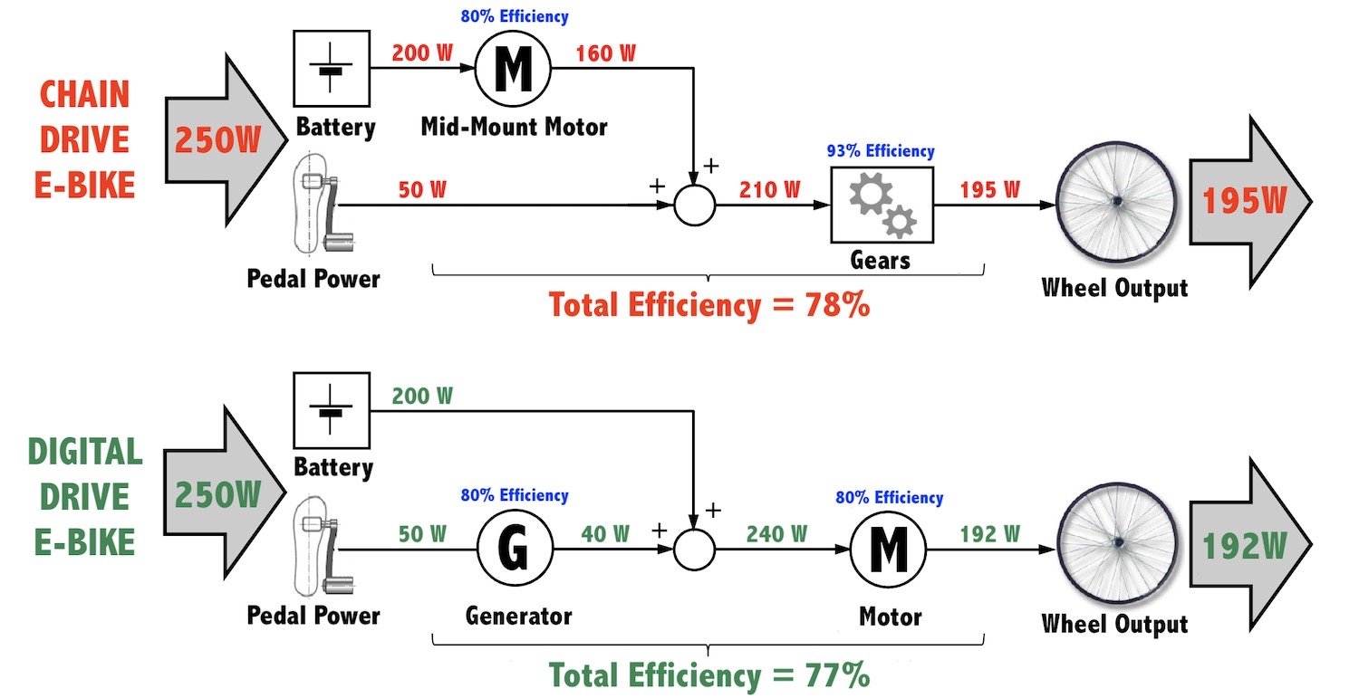

You can get tiny 3000W motor conversion kits. And instant torque is what electric motors are famous for. I´m no engineer, but is it that impossible.
Looking at the TQ-HPR50 motor using Harmonic drive gearing for insane gear reduction(= higher Torque) in a small and light package.
A digital drive will never be a 100%, efficiency and it doesn`t have to be. The battery will make up for it , and it will mostly affect the range. The effiency benefit of a derailleur, chain and casset also fall drasticly with dirt and wear and tear. Something a closed Digital Drive system would not have.
Here is a good article on the subject of Digital Drive. He talked about the effiency
